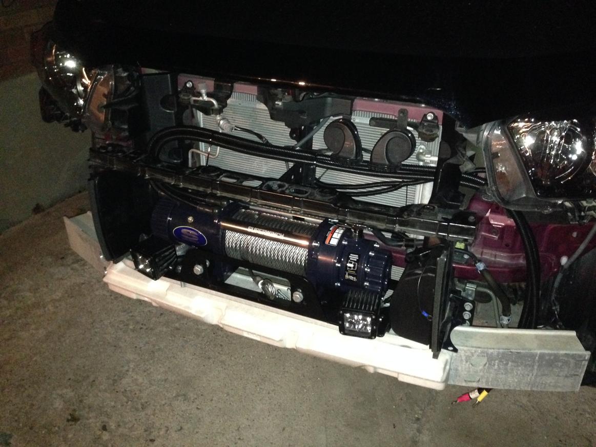

So I am getting ready to buy a winch and drop it on the tray. It has come done to wanting a superwinch talon 9.5 or a warn zeon 10. Still need to do some measurements to see if there is enough room for that bulky superwinch solenoid or if I can relocate the zeon solenoid. Any input here is appreciated :)
My biggest question is what has everyone done with the power steering line that runs through there? At least it looks like it is attached to the power steering pump, the larger dark colored horizontal line, connected to rubber hose sections at the ends. All of the pics I have come across, I can't see in any detail behind the winch.
Thanks
The line is hooked to flexible connectors on the sides and for me it flexed behind the winch and leans on the passenger side of the winch solenoid mount only without being in the way whatsoever. I also just had the bumper skin off over the weekend and checked things out and it is holding up without a problem after a few weeks of driving.

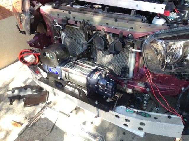

If you want to look up the size of my winch and compare it to what you are looking at, I put in a "Smittybilt XRC-9.5K Waterproof Winch Gen2". The winch and the control box fit in there on the passenger side without any modification except for a small rectangle cutout in the metal mounting bracket that goes from headlight to headlight.
Check out a pic from my install below. If you want some more pics shoot me a PM (just so I get an email) and I'm happy to go out to the garage and pop off the plastic cover and take some shots for you so you can see how that line ended up behind the winch.
Also, ignore my retarded mounting of the light mounts. I figured it out and fixed them shortly after taking that picture.
Man thanks for that! I think just even a bigger pic of the one you took would be more than adequate. I am wondering about the "metal mounting bracket" if it is what I think it is I have some lights just behind my grill mounted to that.

I think uploading from my phone yields a bigger picture (sorry for the delay). I took two nearly identical pictures so I'm posting them both in case one is slightly better for you.
No worries, thanks again :) in fact I just started today, the silly Talon solenoid is f'n huge, I would have had it done today if I didn't have to move it. Going to move it to the driver side of the winch, hoping against the plastic shroud. Second pic as it sits now.
I would move it into the engine bay. My front camera is mounted at about the same height, and it goes into submarine view more often than I would have thought. A sealed contactor might be OK, but open solenoids are asking for trouble.
Thanks for the advice. I would love too except I haven't got any room for it! Stupid smog box, a 31agm battery in the stock location, a ARB twin in the pass side behind the air box, and switches/breaker box behind the fuse box. not much real estate in the 2013 :(
This superwinch claims to have a sealed/submersible solenoid. Believe me I would rather put it somewhere else. I am still thinking about it, I haven't committed to putting it there. I might just tear it out of the supplied box and make my own. I got the long relocation kit so I got 6 feet to work with.
I don't envy your secondary air injection system, have had to deal with them failing on previous vehicles.
If they claim it is submersible, it's probably OK.
