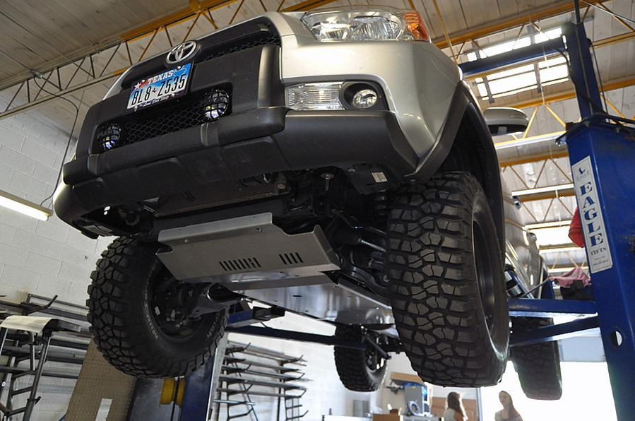

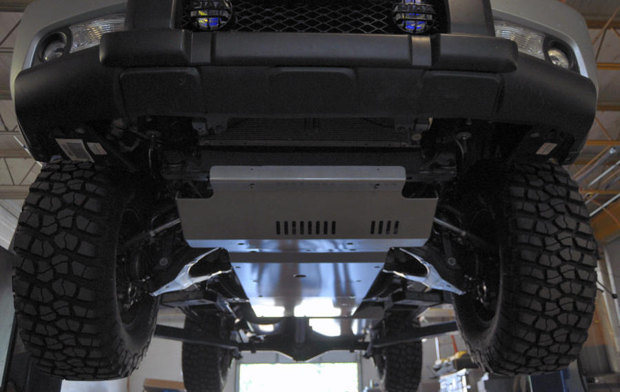

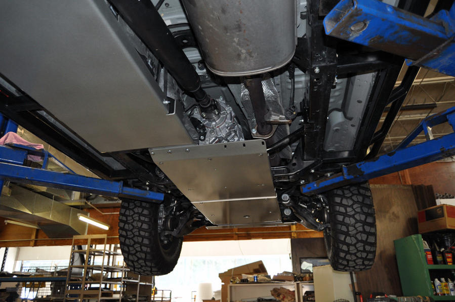

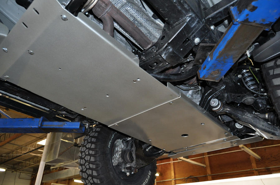

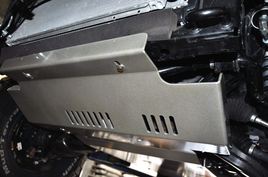

I had Budbuilt skidplates fitted and installed yesterday in North Carolina while on my way back east on vacation.The differential skid,not shown in the pics fits perfect too and has to be shipped to me after powdercoating. It looked great too! I'm in Virginia , land of no radar detectors, now after a great drive up the Blue Ridge Parkway .
I took the stock skidplates off before I left home.They were all beat up and dented already.I could literally bend them with my bare hands.
They are the same skidplates he had CAD designed and laser cut out of 3/16ths steel plate for the 2010 FJ's. They only needed some minor tweaking to fit 5th Gens. without KDSS . Perfect fit now on my Limited and he just needed to fit a set to make sure.
He really needs to get a Trail Edition with KDSS in his shop in North Carolina to design the front skid as the sway bar hangs down lower then the Limited/SR5/FJ's. Beatiful drive thru the mountains!!
Bud's engineering and craftsmanship is outstanding! Truely an asset to the Toyota 4 wheeling community and has been for years making practically indestructable body armor! Great guy in person too!
Here are a few pics on the lift....

nice,
i take it everything bolts up to the factory skid plate holes?
Yep, except there is a new frame crossmember that he designed that attaches to existing holes in the frame for more support in the middle.
They look unreal!!!!! How is it going to be for changing the oil?
I don't see a problem,that front skid can be removed by itself and there's a hole for the drain plug.

Easy bolt on with 2 people,maybe 30 minutes.
The reason I went there....He designed these for the 2010 FJ he had in his shop.I was traveling that way anyways and he had check the fit since it was the first 5th Gen 4Runner he had in his shop to work with.He could'nt sell them til he made sure of the fit.
There ARE a few small differences underneath from th 10' FJ. There is a extra doubler on the 4Runner frame where his support crossmember sits so he had to design/fab up new longer end brackets to work with our 4runners existing holes in the frame.And one of the gas tank skid brackets is a little different so he design/fab a new one of those. Also the rear diff skid plate had to have about an 1/8 inch trimmed off around where a couple of bolts in the rear diff were.
He noted the design differences to make ones for the 5ths without KDSS in future orders. They fabbed mine up while I waited to make sure they work and that's what took awhile.He also took some measurements/pics for some other stuff he has up his sleeve to design for the 5ths.:frog:
That is why he needs a TE with KDSS in his shop to test design/fab/test fit. The KDSS sway bar is located down lower so a design change for the front skid is in order and he has to see where the KDSS lines run and where reservoir sits on the drivers side framerail.
