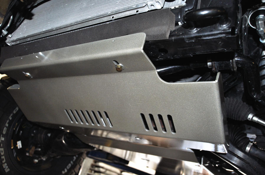

Is that mid piece bolted into the body or is it connected to the front skid? I wonder how this'll work with my shrockworks front bumper.

The middle piece is bolted to the frame,not the body and the front skid plate butts up to it. It has a tab that sticks out the back that goes under the middle one with a special flush screw that takes a 5mm allen wrench or socket. It helps to hold it in place while you install the other forward bolts. Use generous amounts of anti-seize when installing ,as always ,on bolts and nuts under the truck.Makes life simpler down the road if you want to take them off.
As far as it tying in a shrockworks bumper,I'm sure a special filler plate will have to be fabbed ,like the one I made for mine. Any sheet metal shop could do it as it's basic sheet metal 101 type work.

I love mine.......for rocks! Telltale rock gouges and scrapes all over them means they are doing their job. I have a deep gouge and it is actually bent on the BB gas tank skid that probably would have ripped my gas tank open with the stock ones.More then paid for themselves right there IMO!
It's been awhile since I've seen the black plastic trim of the Limited/SR5 but I believe there will be a gap if you take them off. The BB front skid basically replaces the thin oem one.
