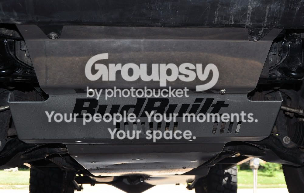

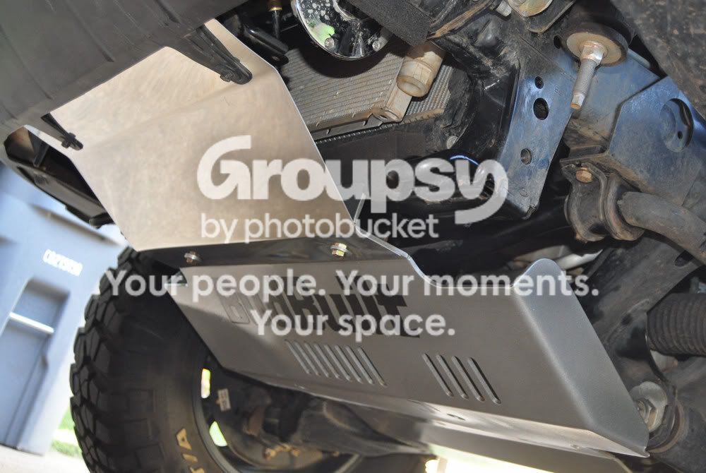

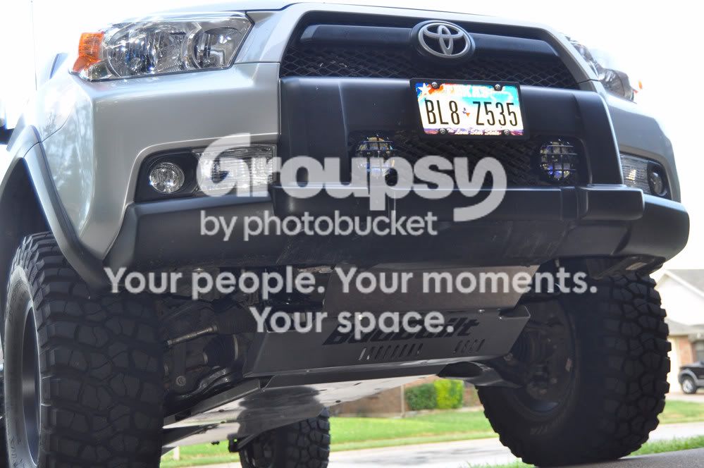

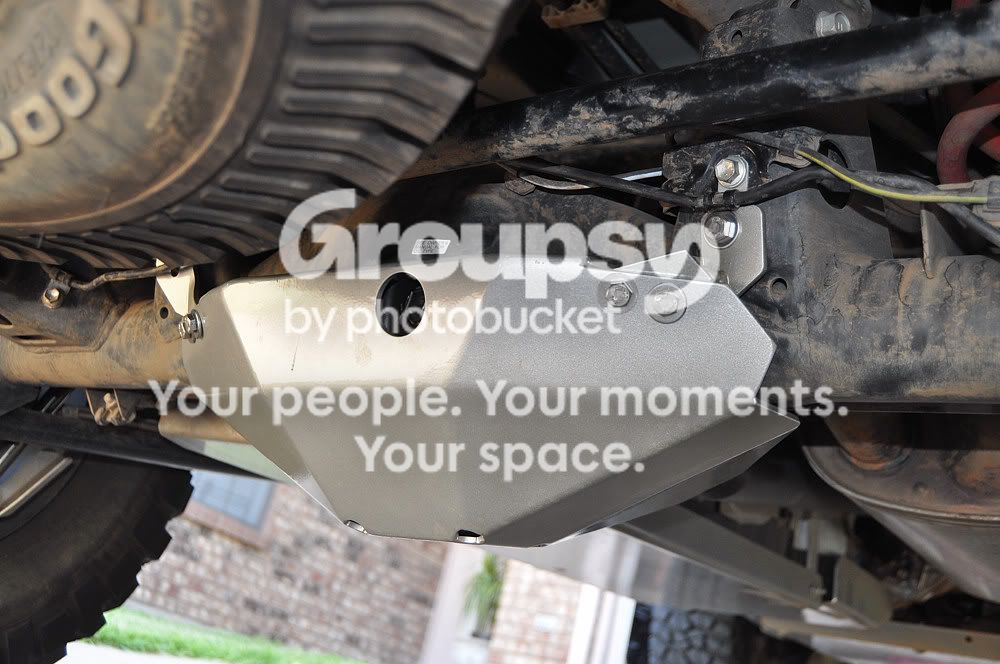

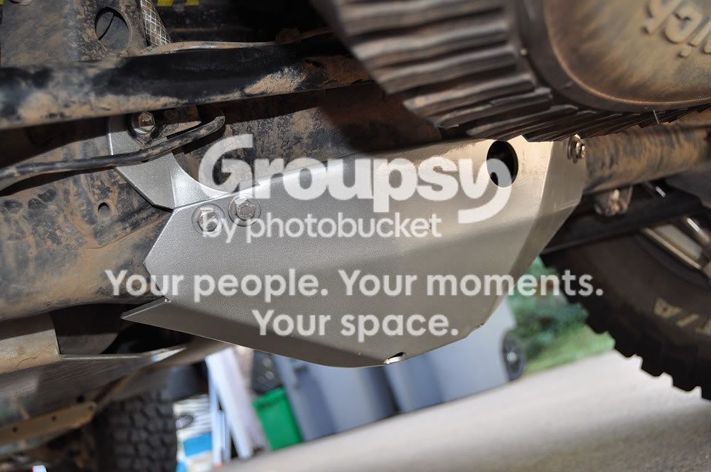

I finally got around to installing my BudBuilt Differential guard this past weekend.
Very easy install and fits up very tight so I only lose about 3/16 clearance,which is the thickness of the armor. I did get a few gouges in the the differential wheeling in Moab and a bunch on the skid plates. They probably paid for them selves already!!
Here are some pics.
Picture007-2.jpg~original
CopyofPicture006.jpg~original
Picture016-2.jpg~original
Picture028-1.jpg~original
I also made a front filler piece to tie the front bumper into the front skid plate. I made it out of .050 7075 t6 Aluminum and bent it to fit. Bud is supposed to be coming up with this piece also if he didn't already.Painted the "BudBuilt" black where it was laser etched also when I had it off to change the oil.

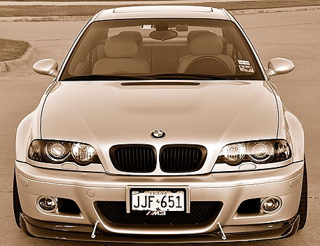

A highly Modified 2002 BMW M3 pushing 400+ HP and before that Porsches. A 87 911 Turbo and a 89 944 Turbo.
Barely avoiding the cops going 155+mph street racing a Mustang changed my outlook on sports cars.He got caught as he was behind me!The M3 went up for sale the next week!!
4Runners are so easy to work on compared to German sports cars and they don't go very fast either. Brought me back around to my 4 wheelin roots where I started too.
