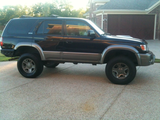

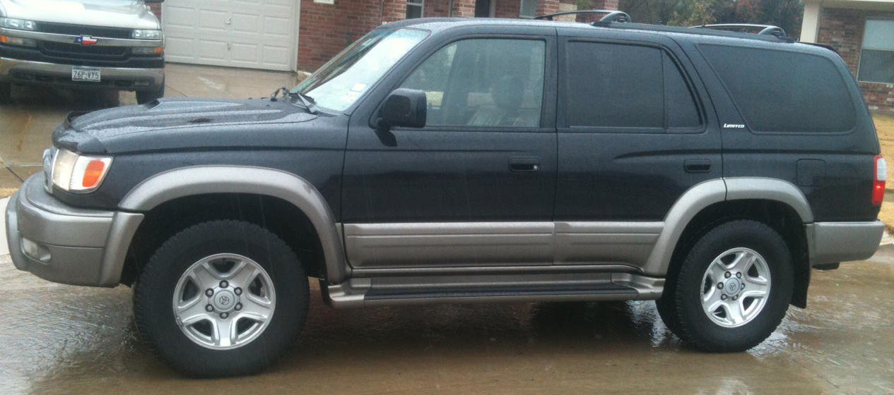

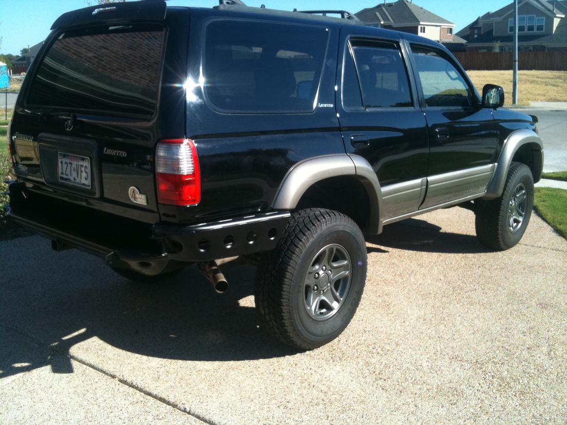

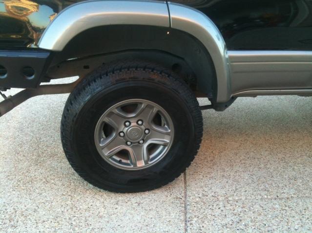

I need you to vote. I like the new color much better than the graphite, but not sure if I like it as much as silver. Take a look and let me know what you think.
Stock Silver
Graphite
Attempting to match the trim color
Close up

I think the closer to the trim color, the better. I like graphite, but on your color combo I think there would be too many different shades competing with each other. 2nd best would be to match the body.
I'd say go with gloss black since you have a factory black body, black rear bumper, and your future front bumper will be black as well.

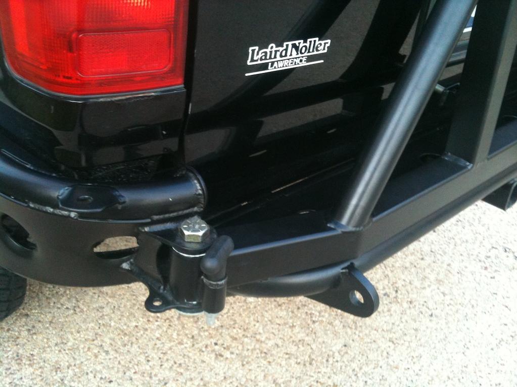

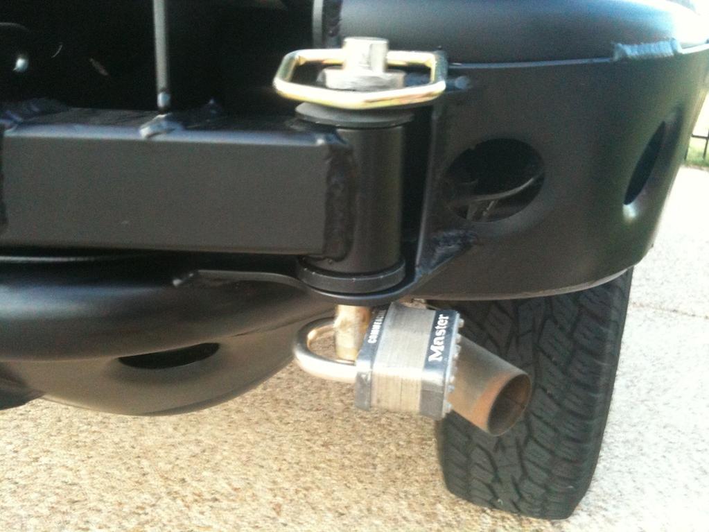

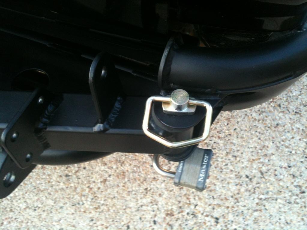

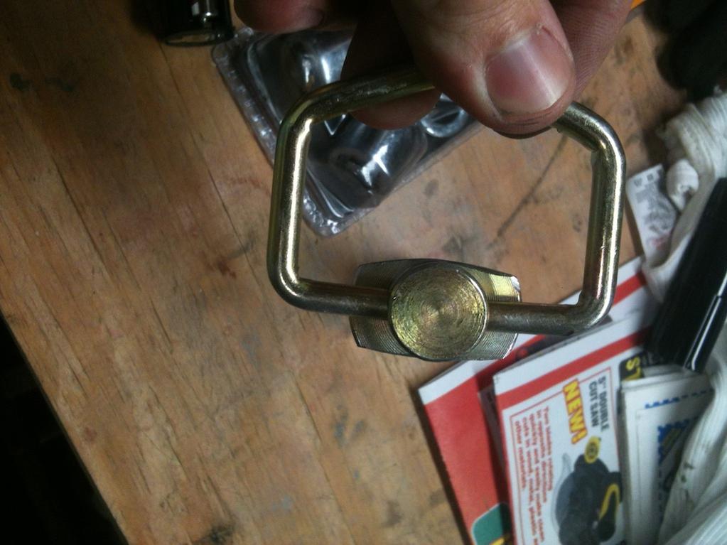

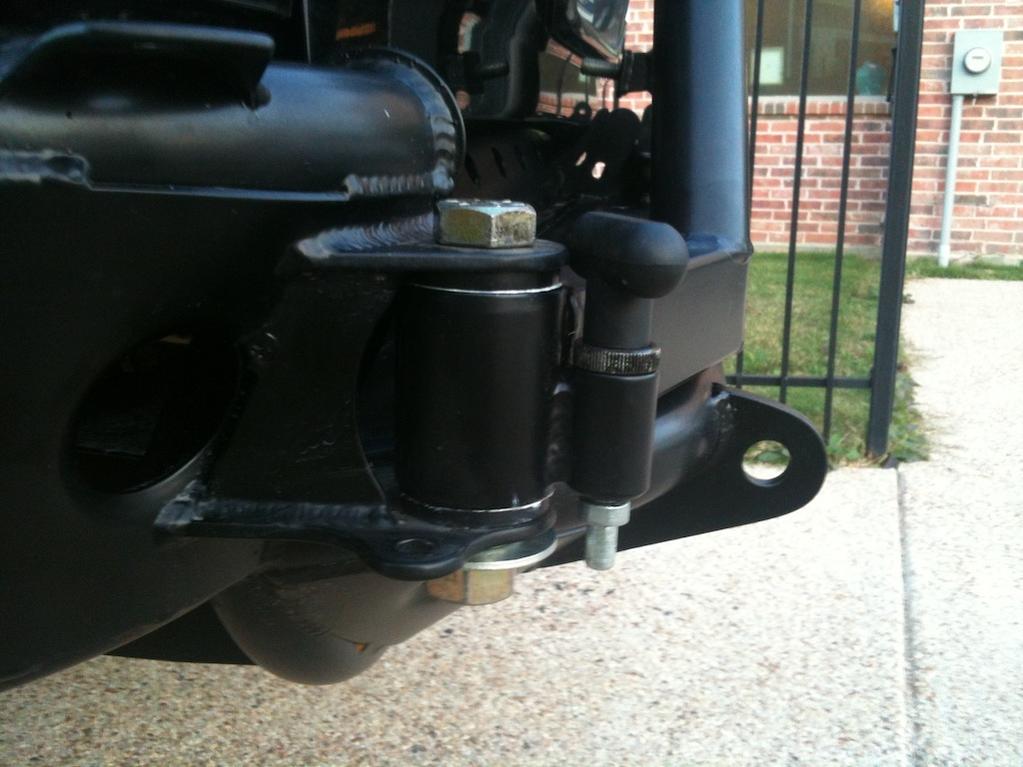

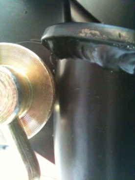

A little update. I got around to modifying the swing-out arm and hitch pin to attach it the the bumper. I had to buy a metal cut off wheel for my grinder bc I only have diamond blades. Here is what I was dealing with...
Here is how I addressed the issue...

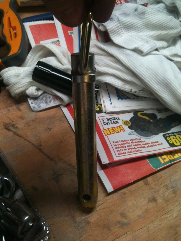

I also had to buy a 3/4 drill bit to drill out the rubber bushing on hitch pin side of the swing arm bc they didnt quite line up. Next I took a 3/8 drill bit to the hole in the hitch pin to be able to accommodate the bigger lock. After touching up the powder coating I was good to go...

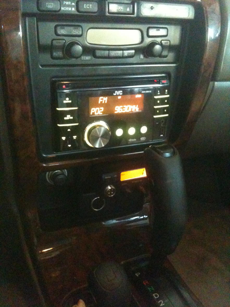

New head unit and Cobra 19 CB Radio installed.

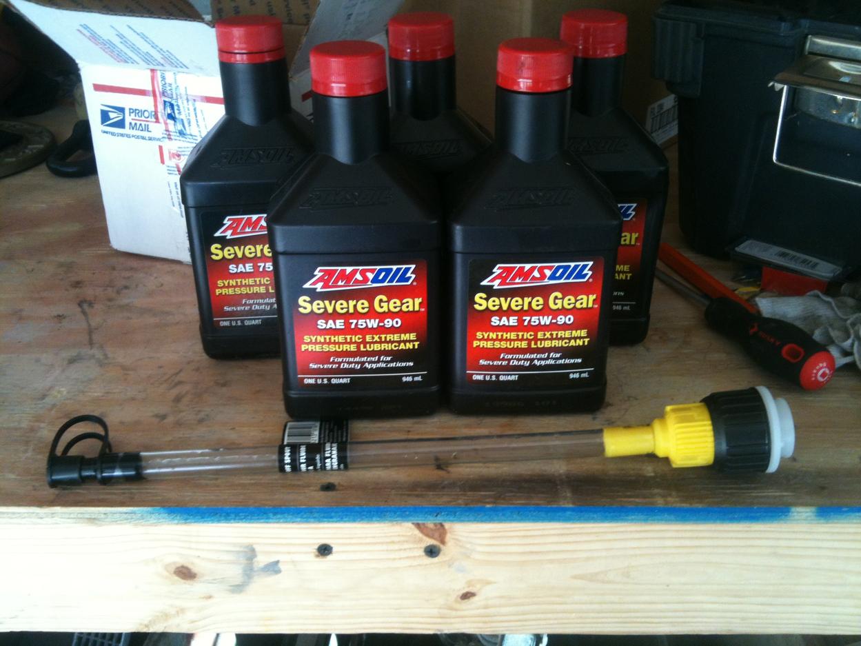

Changed out rear diff, transfer case, and front diff fluids.

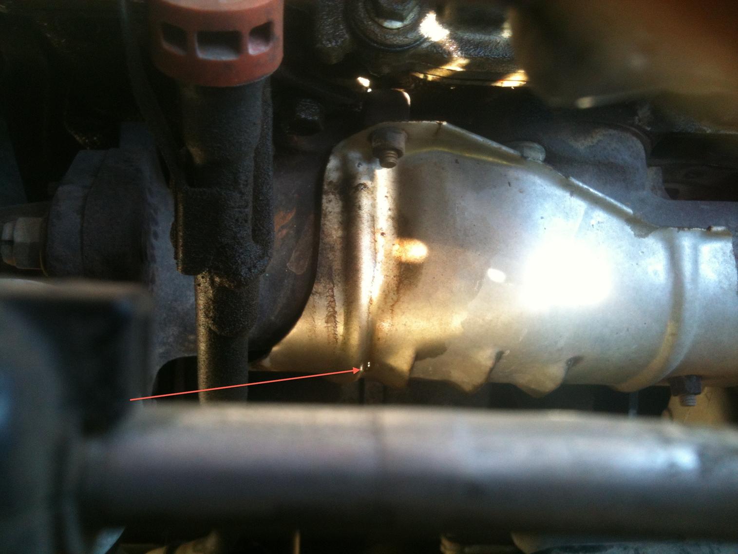

Fixed oil leak (pretty simple, tightened bolts around the valve cover. They were hand loose)

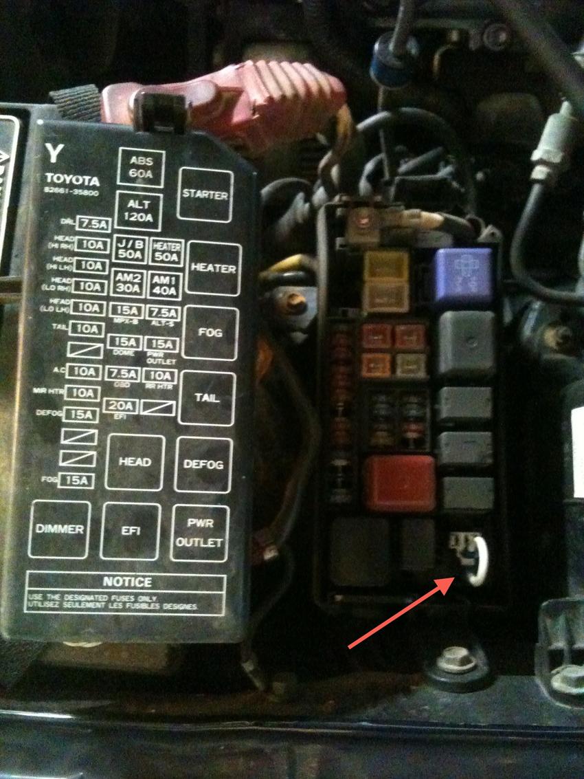

Continuous 12v power mod. I should have don't this long ago. This was always one of my pet peeves about 4runners. Didn't know this existed. Super cheap and easy to do.

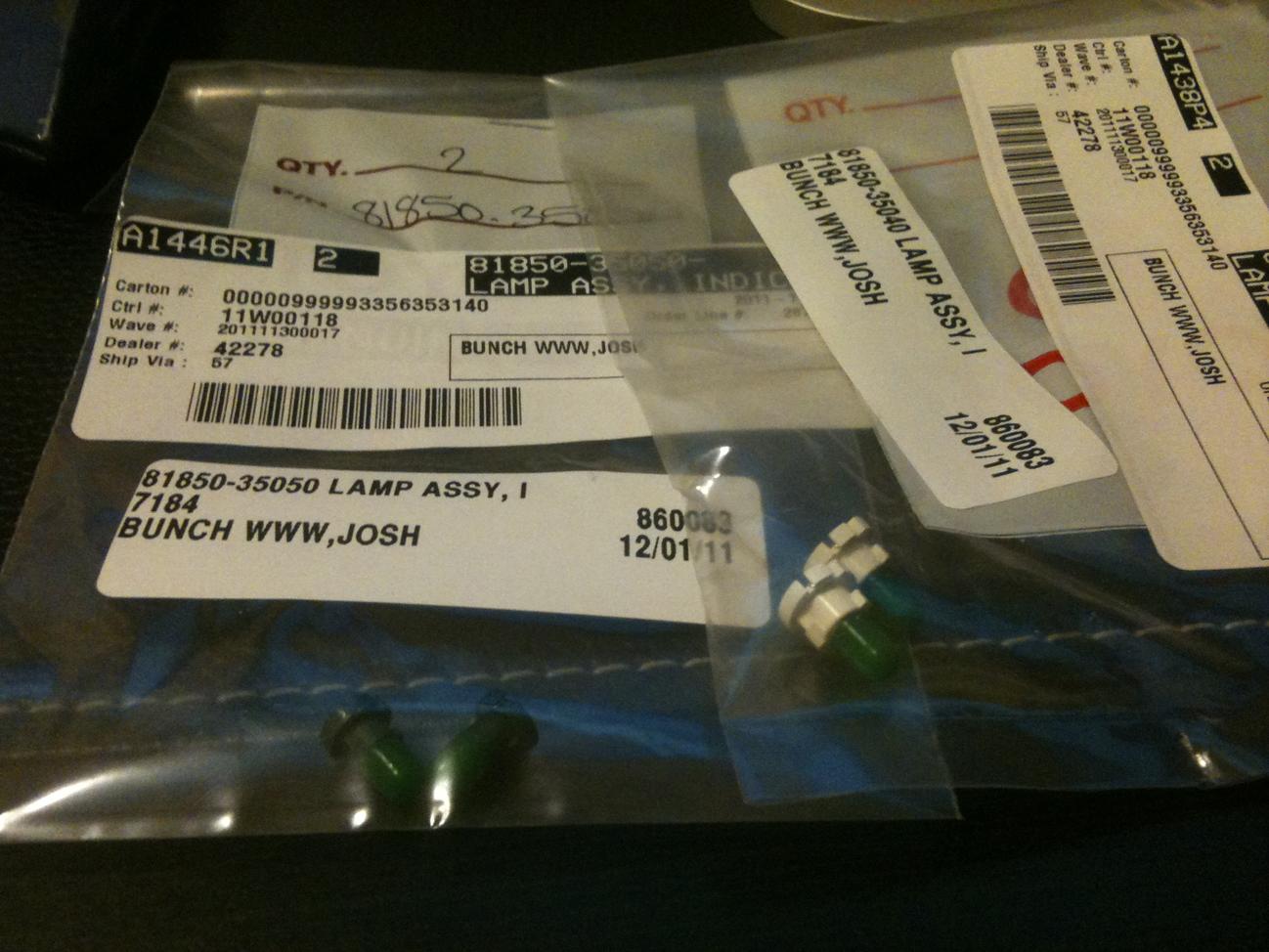

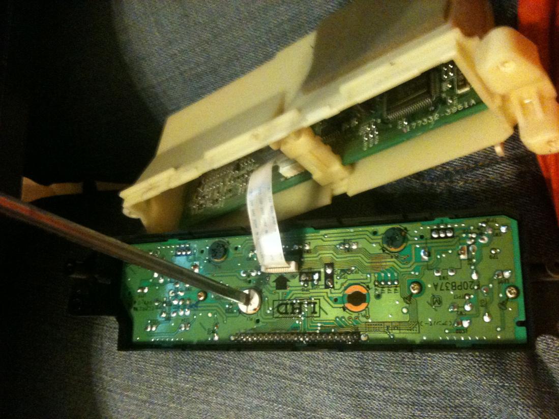

Replaced the burnt out lights on the A/C control display and buttons.
