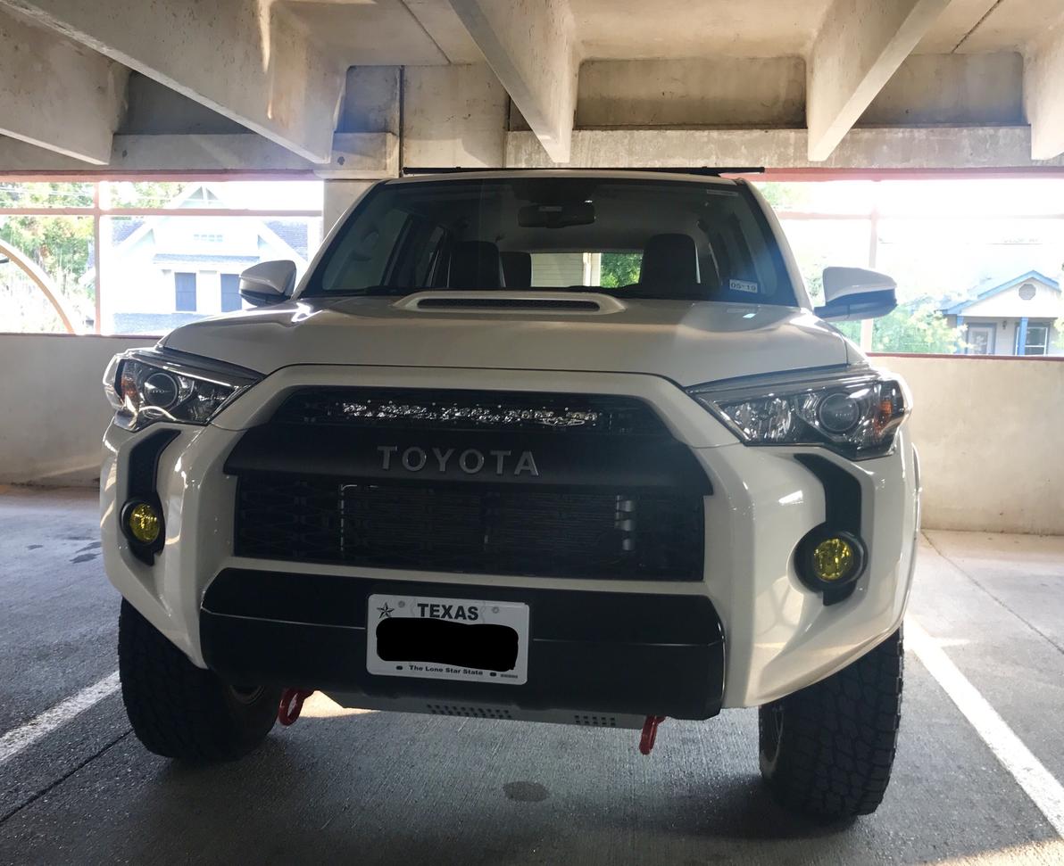

Thanks for the light bar write-up, made install a breeze!

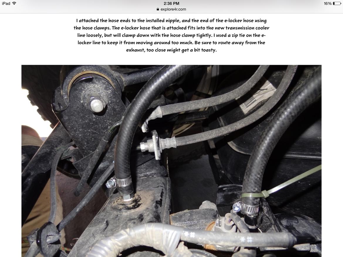

On your differential breather mod would it work using a nippled tee fitting underneath connecting both hoses and then running one hose from there up into the jack area?
Great thread and mods, my favorite.
Hey! Yes, you can run them with one line from my understanding. I just wanted to be extra weird and run separate lines.
Thanks for the kind words :thumb3:
