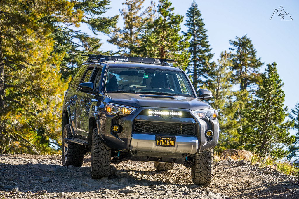

For a shake down run, it was all that I needed...
Looking forward to your next adventures! How do you like the ride so far?
Me too! And as always, I'll share the next adventures with you all! The ride is nice. Definitely different. Firmer, but in a good way. I'll be writing a post soon on my website as to why I upgraded and my impressions post-installation so stay tuned!

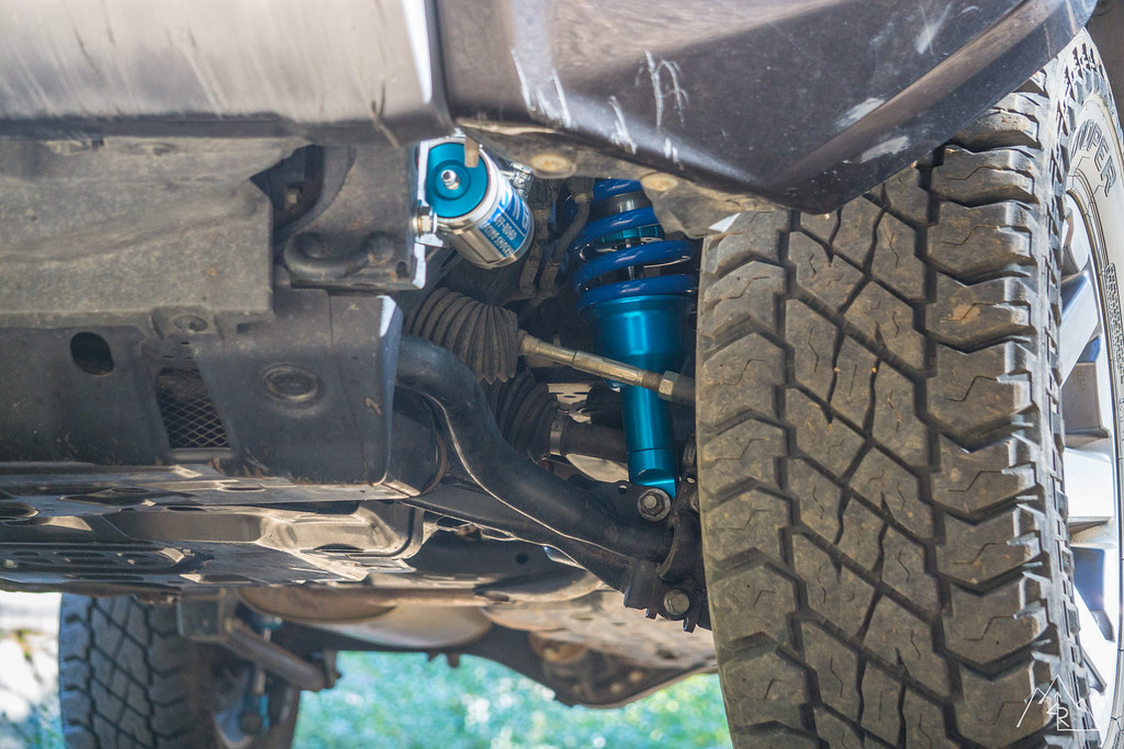

King Suspension Upgrade
I am currently working on a more extensive write-up discussing the research that went into the upgrade, but for now I'll share the basic details!

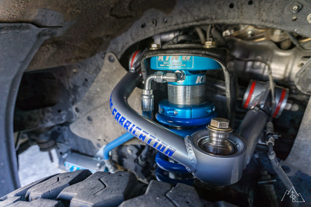

Coilovers: King OEM Performance Series 2.5, extended travel, no compression adjusters, 12 turns on preload collar.
Note: This is being reduced to 6-8 turns in a week. The ride is currently too stiff, and a bit too tall. Target height is 2.25"

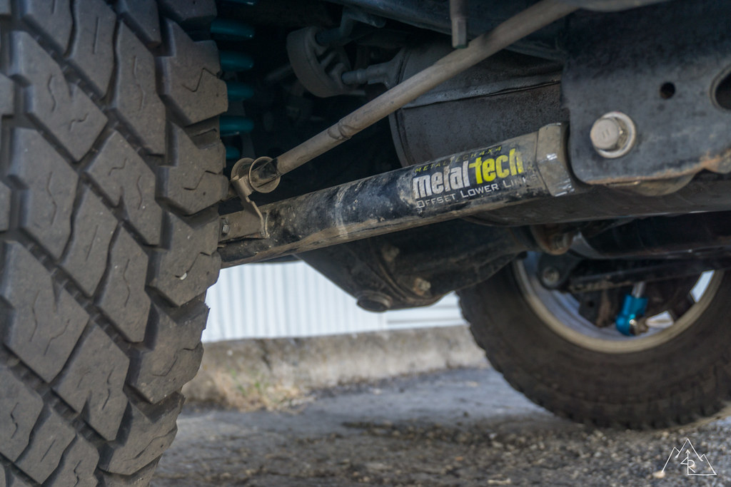

Upper control arms: Total Chaos Uniball, Poly bushings

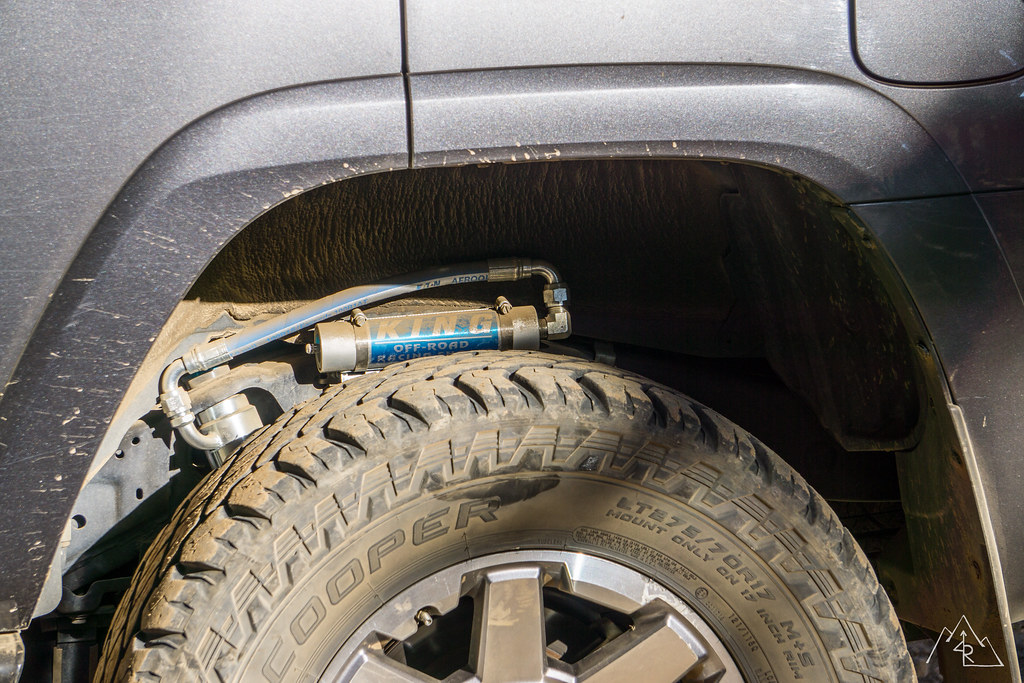

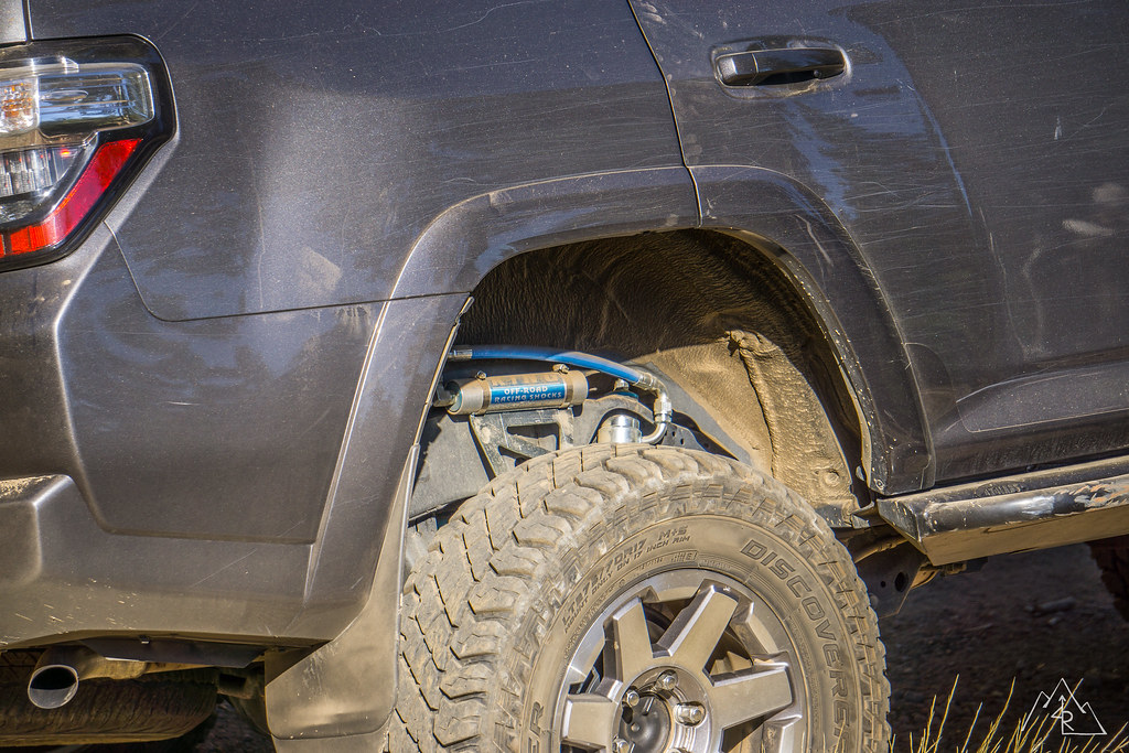

Rear shocks: King OEM Performance Series 2.5, extended travel, no compression adjusters
Rear coils: Dobinsons 2" lift, KDSS specific, standard weight rating (10-15% over stock)
Lower links: Metal Tech 4x4 offset rear links (Thanks, [MENTION=89562]bimrunner[/MENTION] !)
I ordered and had everything installed at Califabrication in Sacramento. I had saved enough for the suspension plus installation and really just wanted to have it done for me because while I trust my ability to work on the rig, I wanted to have it done correctly with less risk of me breaking something during install. Chance, the owner, was great to work with on both ordering and installing.
On my first test run the next day, the new shocks performed well. The added clearance was very welcome, and the bump dampening at speed over larger objects was very nice. Low speed and smaller objects the ride was a bit stiff which is why I am adjusting the preload. I gave the shop that installed them my parameters of 2 to 2.5" of lift. They set the preload to what they have found to be about 2.5" of lift, but ended up being closer to 3". I didn't measure the after until about a week later, so after talking with King and the installer we're reducing the preload to between 6 and 8 turns which should put me just over 2" of lift. This will give me a softer ride, and will put less stress on my components in the long run. I should have done more research on the front end myself so I could be more specific with the installer, but you live and learn.
