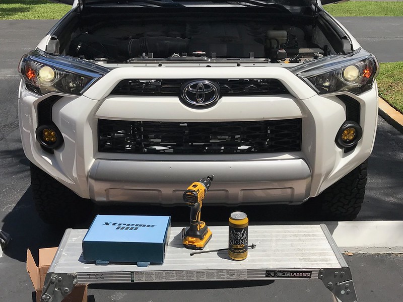

I gifted myself a set of [MENTION=12905]XenonDepot[/MENTION] Xtreme HID's for the low beams on the 4Runner. I really like the ability to see as much as I can on the road, and once I saw the light output from my dad's GX (which is LED, but still much brighter) I knew that an upgrade was in order. After reviewing my options, I settled on the Xtreme HID kit, with the Philips bulbs.​
Parts used:
- Xenon Depot Xtreme HID H11 kit
- Drill of choice
- Milwaukee #9 step drill bit
- Scotch Extreme Fasterners
- Knee Deep Brewing Midnight Hoppyness
Everything laid out (including the fuses, which I didn't use)
