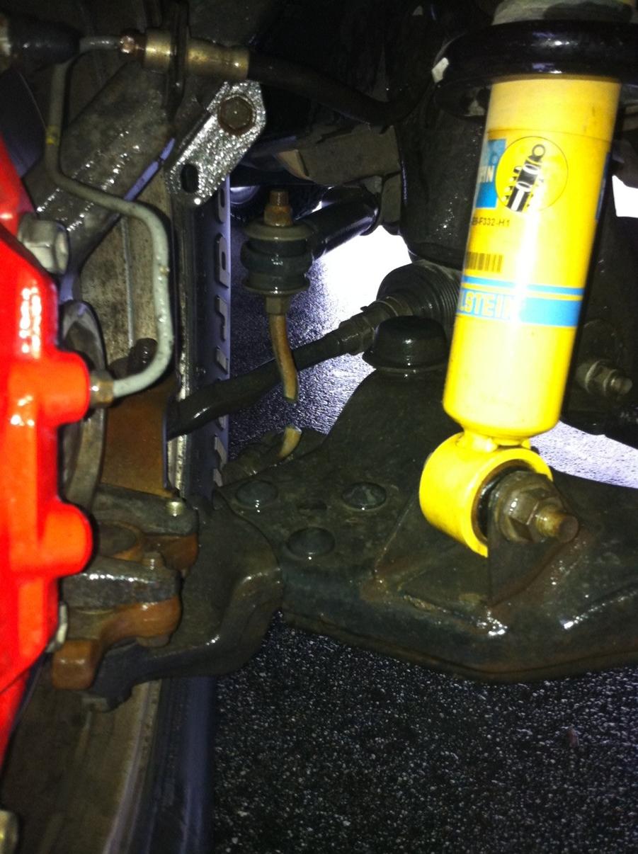

These work great!!! Just gotta take them back off, fillet one edge and paint them :D Here are the pics.
side by side
1021001350.jpg~original
Flexed out in this position but enough to show how they function.
1021001506a.jpg~original
1021001506.jpg~original
Here is my only concern but i think the front was atleast 90% flexed out, the rest is going to come from the rear. the sway bar next the frame. there is another 1/2in before it hits i think its going to be just fine but i need to go test some more actualy looking at the pic you can see the front bump not in contact...opinions here on this one please guys.
1021001506b.jpg~original
As far as getting the pins in and out, it was way easier then i was expecting. lay under there, jiggle the truck but the sliders with one arm and push/or pull on the pin and they slide right in and out. Now on to some more testing and paint :D:D:D:D

well back to the drawing board...they work great, lets the truck flex great, pins are easy to remove/install. they are 100% go if your wheels are strait...... if you turn while FULLY flex, the sway bar itself pushes into the tire and i wasnt even at full lock. im gonna cut them down a ~3/4 and see if it changes anything but as of right now im kinda bummed. gotta think of something else. ill see if i can get pics. truck looks awesome with the front flexed out however :D
