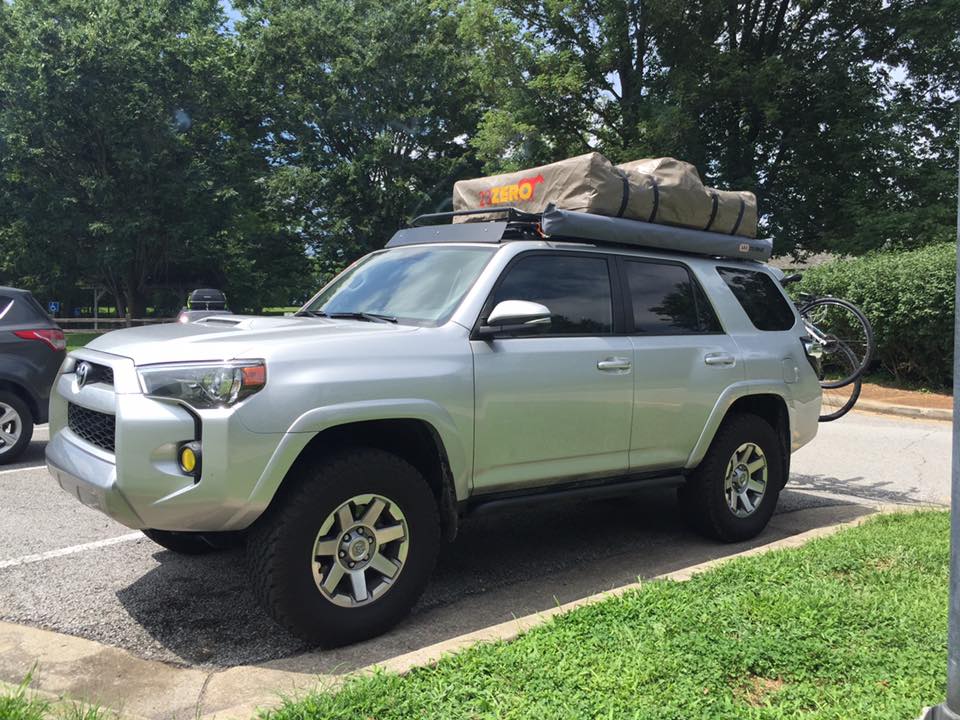

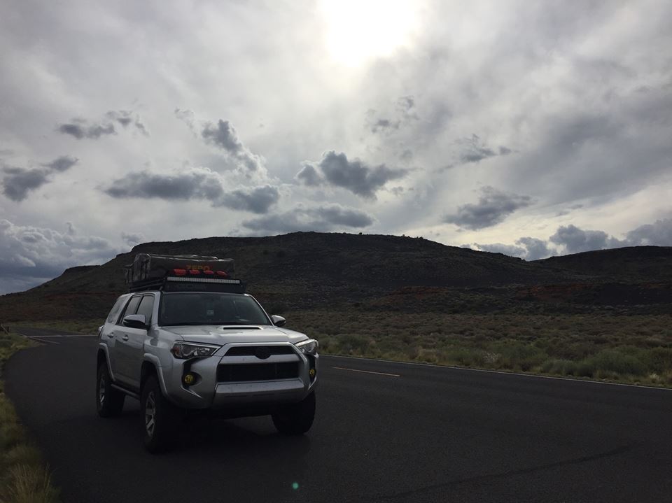

I had overland springs and bumpstops, first trip I took with this setup I noticed the rear sagging pretty bad. So I ended up with Airlift bags in the back as well to keep from riding on the bumpstops when the road got rough.
I've really liked this setup, just changing airbag pressure when I have more or less load lets me be comfortable all the time.
Attached 2 pictures. One is the first trip with the noticeable rear sag. The other is after adding only airbags to the setup.

If you plan on having weight back there most of the time, go for the Overland springs. Just keep in mind for the times you don't have the rear loaded or before the bumper comes on you'll have a pretty rough rear ride and 3" lift in the back. Not to mention that without weight you are limiting your downtravel because of the added lift. Without my RTT and drawers (just my rear bumper), I have a pretty serious rake front/rear.
