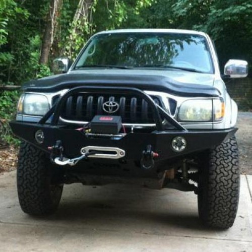

I didn't have the 4runner version but had an nwti bumper on my 2nd gen Tacoma and loved it. I've been contemplating buying one for my runner in the next couple months. I like the look of their open top design
