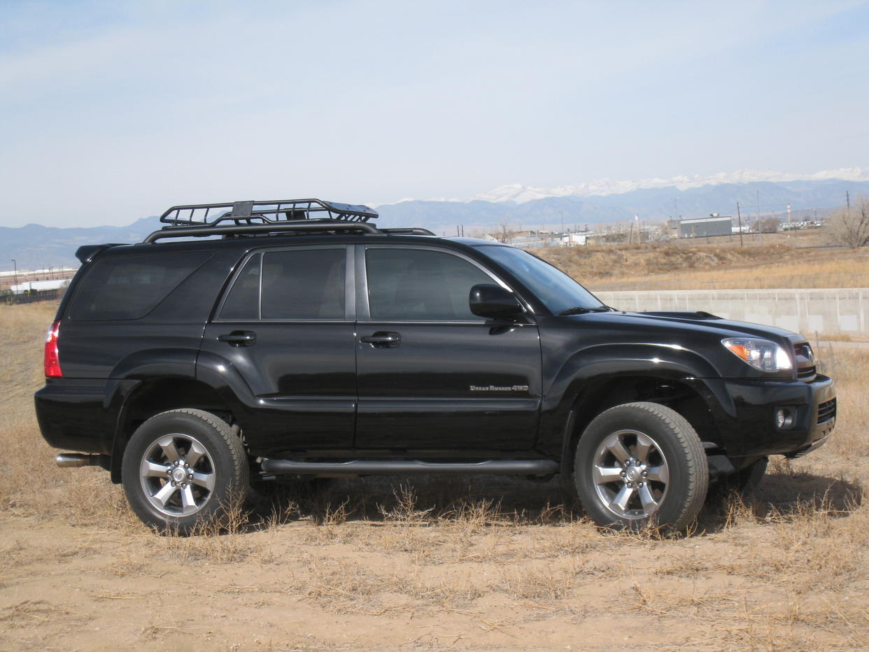

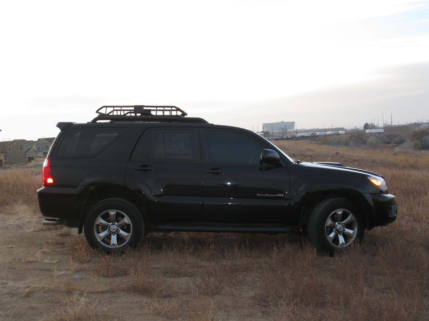

Couple weeks ago Mojo and myself installed FJ Springs, toytec 1/2 spacer, and spidertraxx wheel spacers ( 1.25) on my 08 UrbanRunner. I know it's been awhile but the weather has been bad and it's been super busy around my house so here we go:
Stock mesurements:
Front 33.25'
Rear 35.25-35.5
After FJC springs & toytec spacer
Front 35.25
Rear 36.65
I think the Runner looks great now and i love the aggressiveness the wheel spacers were able to proved as well as the TOYTEC spacer and springs to level it all out. Since I've had it the responsiveness of the vehicle has been better 10 fold. It is much more of a stiffer ride but better at that. Also, when taking turns I'm not thrown into the passenger seat so that always a plus. Now i just can't wait for my new tires!!!!!! Any recommendations on size? 265/70 or 265/75? What do you think? Im planning of getting the Hankook Dyna Pro ATM's.

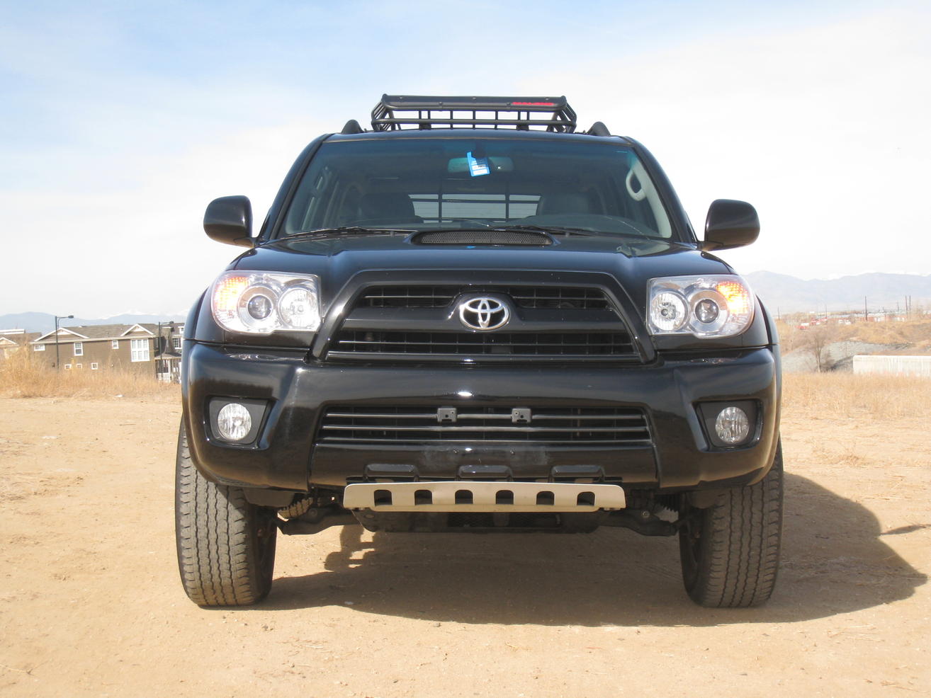

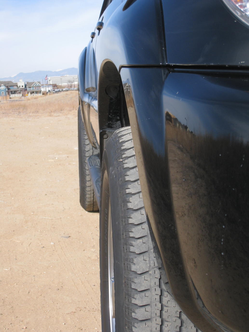

Few more so you can really appreciate the Spidertraxx.

I went with 265/70's and think it's a great size with the lift. I did have rubbing after I installed the Spidertrax, but easily corrected that. I just had my alignment done yesterday so I have to see if I need any additional clearance. Another size to consider would be the 255/75's that are gaining popularity.
