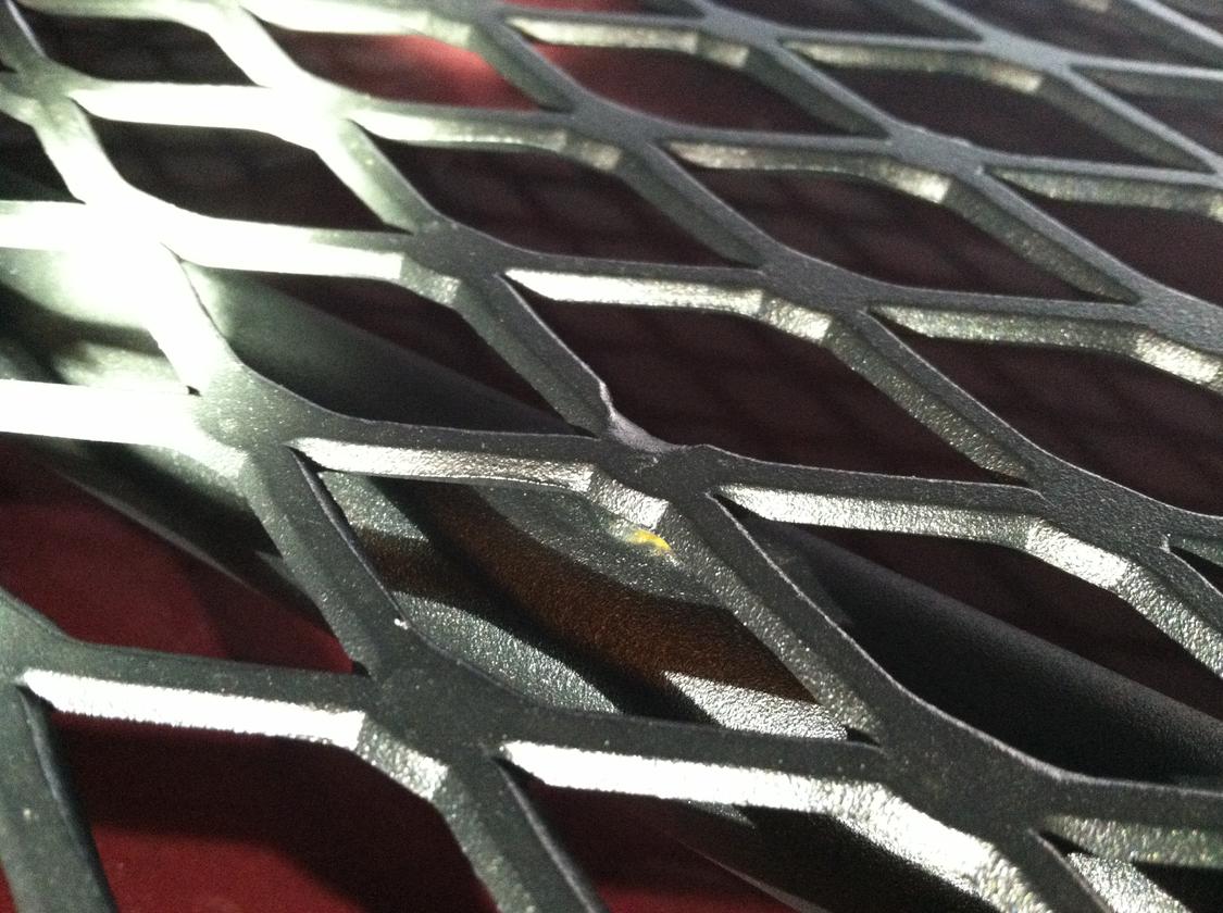

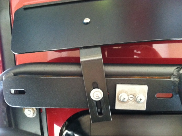

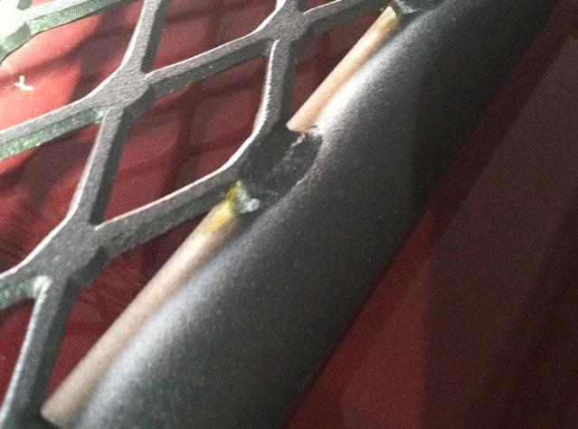

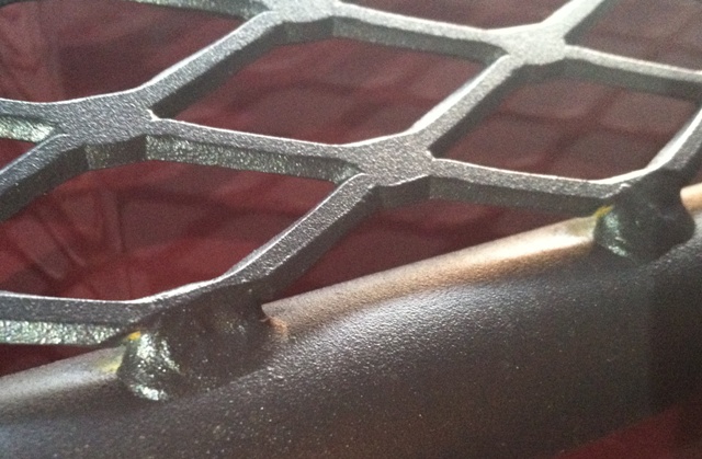

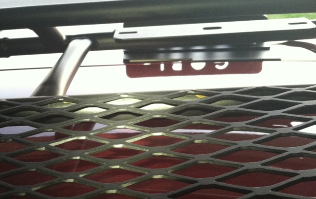

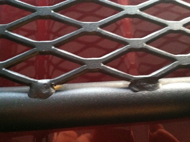

Washing the ride today and got up top and spottted rust on my 5 month old Gobi! Gobi's powdercoating has failed.
After waiting so long - please dont fall prey to this metal cancer!
I took emergency measures with what I had and cleaned area and coated with Plasticoat...(bandaid until I can take more permanent measures).
What a bummer. My Yakima LoadWarrior sat on top of my 4th gen for 3+ years without a spot of rust.
Well, if you have a rack up top does not hurt to get a cloaser look for the metal cancer.
I will say that I have confidence in Gobi, although, I will not be taking rack off for a recoat. Ill touch base with them and see what options can be had.

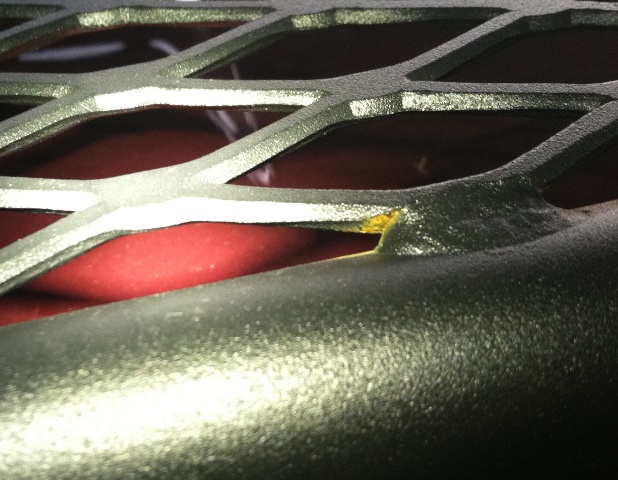

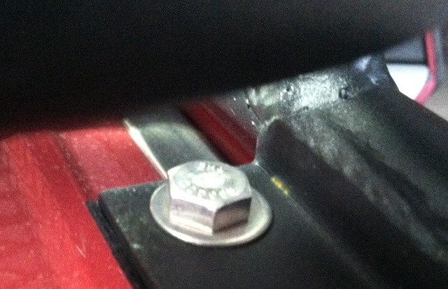

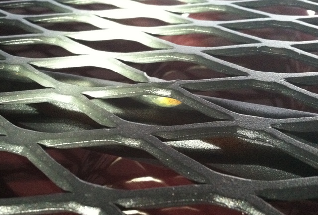

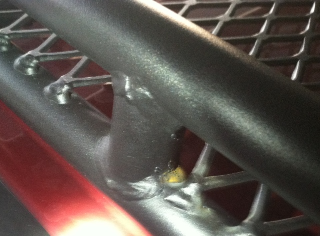

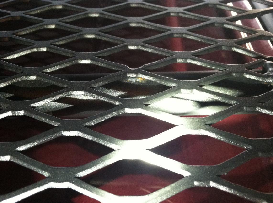

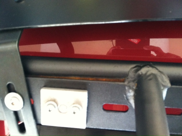

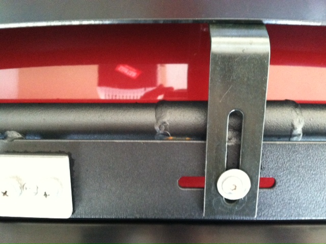

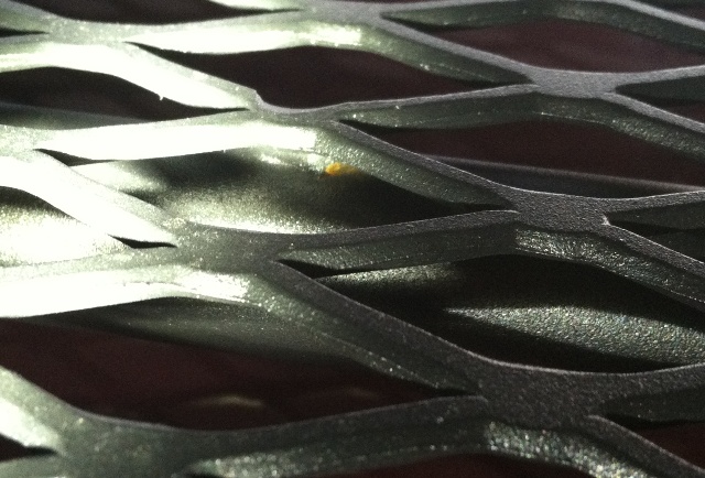

So after my last post I decided to look for more rust...and as much as I hoped not - the rust was everywhere. No can of touch-up will suffice. This is going to need an overhaul.

A few more pics from the second discovery...:sobbing:

I see several problems or issues here.
*) The product is lacking in quality. OK, this happens from time to time and it’s up to the vendor to make things right.
*) Based on shawn719’s description, this isn’t just a localized problem but covers a large portion of the rack. This makes doing a field touch-up impractical.
*) From posts by shawn719 and others, this isn’t the first time this has happened and it seems that Gobi has known about it for awhile and is ‘taking steps to correct it’. This to me is a big problem. When a company first learns about a problem they take steps to correct things. In this case it should have been to jump all over the company doing the powder coating. If, after that, they still encounter issues they change companies, period. They can look into doing the powder coating in-house as well but in the short term they have to make immediate changes to correct the quality issues. This seems to be where Gobi has dropped the ball. Either they don’t know how to control the quality of their product or they don’t really care.
As to what I would expect from Gobi if I were shawn719. I would expect Gobi to make things right and in this case it sounds like the product needs to be replaced. So they should send a new rack and a shipper’s pick-up slip for the old one. I don’t expect Gobi to do this but it’s what I would push for and if they don’t resolve it to my satisfaction I would take steps to harm their sales. 
Have faith - I heard back - by email - from Gobi. Here is what I received:
"Shawn, I will get a replacement GOBI rack for you. It will take a couple of weeks before I can get it shipped out. Once you receive the new one please used the packaging/box to put the old one in. We will have the freight Company pick it up. This will help us determine what the problem is with the powder coating. We apologize for the inconvenience and we will take care of this matter as soon as possible."
So far Gobi is standing by their product. So KUDOS to Gobi.
