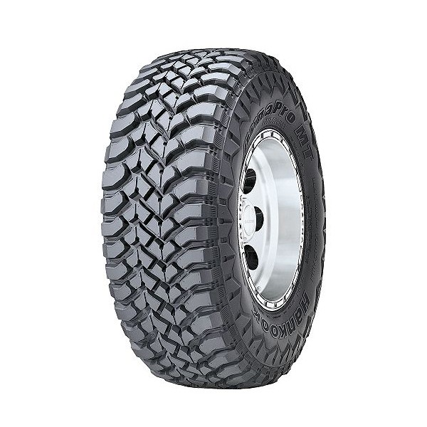

Now I own "gnarly MT "D" rated rubber beasts"! LOL Hankook Dynapro MT's
I think these might be the perfect compromise between softer C & heavier E's.
