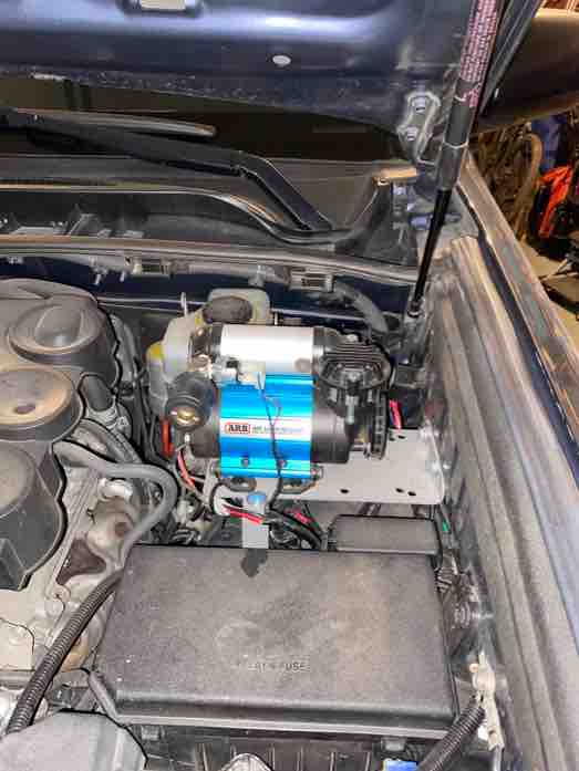

Here's mine. Did have to drill new holes. Mounted the ARB switch straight to the battery (fuse block) in a sealed project box.

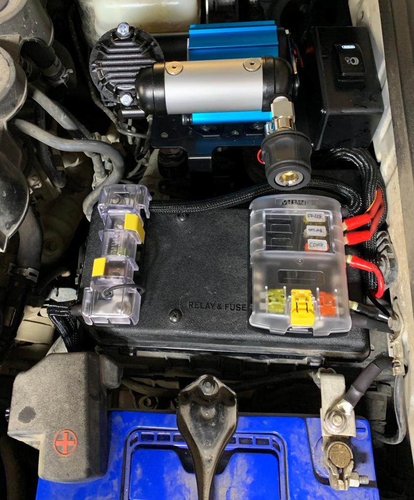

Did the same thing back in April. Had to drill a few holes and the ran an AOB switch into an open factory switch location. image-2020-11-21-08:41:08-099.jpg
  • image-2020-11-21-08:41:08-099.jpg
