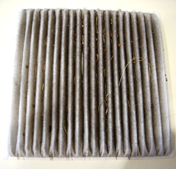

Replaced my cabin filter on my 2005 w/ 17K miles. The original that I took out was disgusting! See the attached pic. If you look close, there is a small dropping from either a mouse or lizard.

I see you live in Pa so your filter may not get as dirty as mine. Also, in Florida where I live, we have those pesky rodents and reptiles that seem to make their way in everywhere.
yep, typical find...yuk
CV
Ewwwwwwwwwwwwwww.
After looking at that, I will check mine too. I probably have loads of crap in it too.
