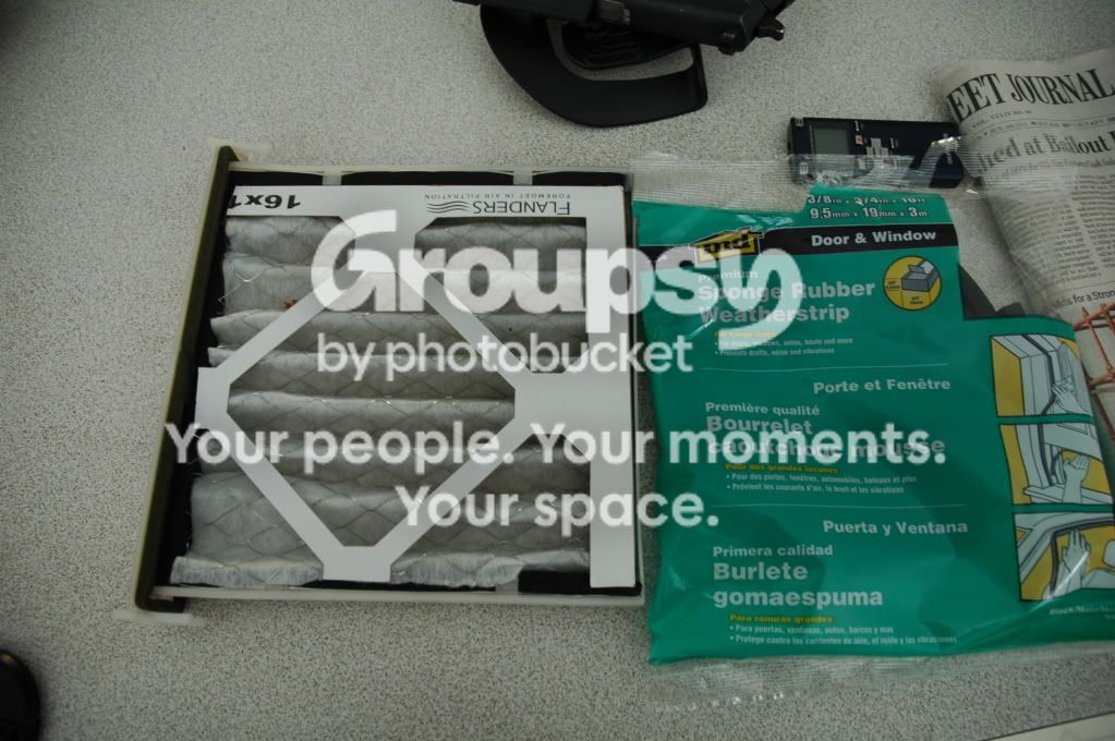

What may help is to put in a little of the sponge rubber weatherstripping on the edges, where the plastic tabs are. Stops you from having to bend the cardboard and fight with the filter material.
Attaching a picture. I added the weatherstripping on three sides and on the bottom side you can see how the filter material simply overlaps some of the weather stripping. The material I used (filter and weatherstripping) was just stuff I had around the house.
