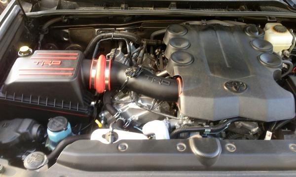

Okay, today I went to get my first oil change on my 2013. I stopped in and to see the TRDPARTS4U folks and picked up a CAI.
I Installed it and to my surprise, the TRD intake is NOT loud.
The air box was larger and the filter was about one inch wide, so I can assume that it does allow for a tiny amount more air.
I will be adding exhaust next week, as I am after power and not MPG. Keep in mind, after the bumper installs next week, my truck will have 800lbs of armor hanging on it.

However, as it pertains to this CAI (TRD) i am very happy with the noise, and I believe it is because it still has a sealed passage into the fender well, so it is true cool air, and you cannot hear the sucking through the firewall.
Since Toyota Owns TRD now I cannot help but think there is more R&D involved than simple fitment like some other brands. I have nothing to back this up, its just IMO.
