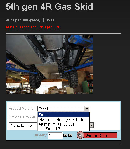

BudBuilt skids... they have a Light Steel 1/8 gas tank skid.
Is that 1/8th" skid any more beefy than the stock skid?
And I don't know the weight of the stock Trail skid but here is what Lisa gave me on the gas tank skids they have at BudBuilt:
  • 3/8th Steel: 66lbs
  • 1/8th Steel: 45lbs
  • Aluminum: 33lbs
