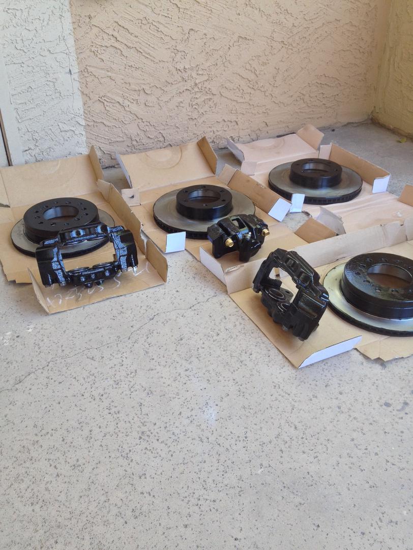

Used G2 also, really happy with it!
That looks fantastic man. I don't plan on taking off the caliper as bleeding the brakes sounds like a nightmare.

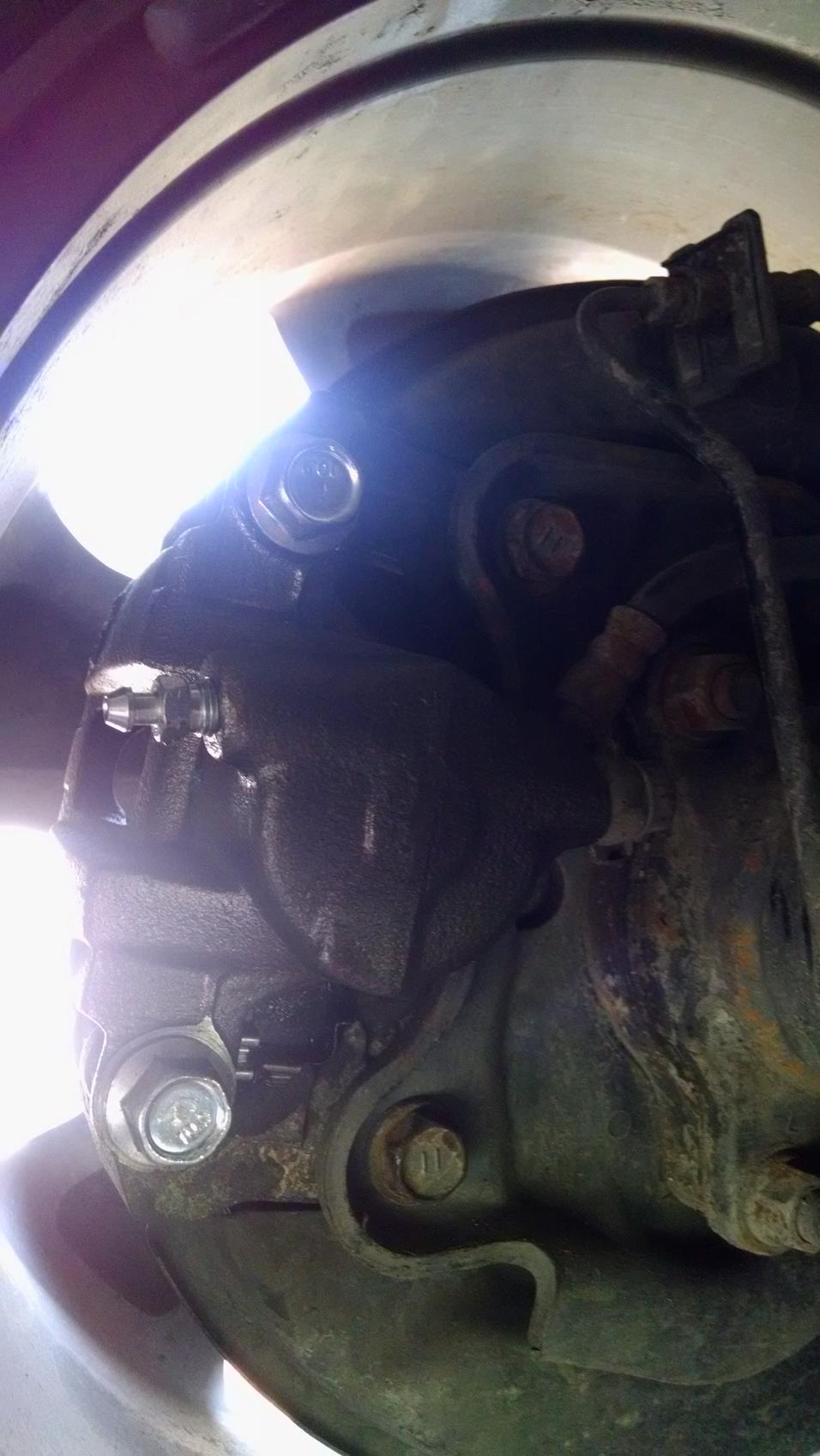

To my understanding after taking off my rear tire there are just two 17mm nuts to remove and the caliper should come off. Does anyone have a picture of of the rear brakes to identify proper nuts?
Thank you [MENTION=101314]sr3tlaw[/MENTION]! The paint goes on with a brush so i think it would be fairly easy to do on the vehicle as well. It is a little thin at first till the activator has time to work, but other than that it stays right where you paint it on, no drips or runs at all.

So which nuts need to be removed to take off the caliper ??
