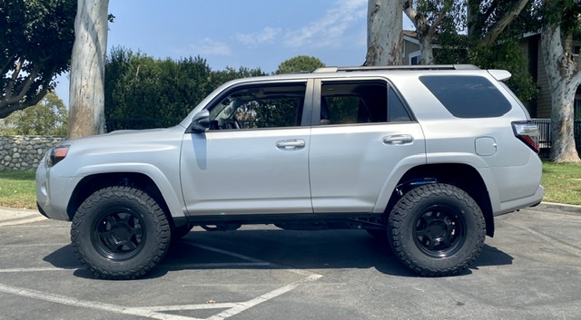

- Year, model: 2016, TEP
- Compression Adjusters: yes (8 on-road, 0 off-road)
- KDSS: yes with Dobinsons 15mm rear spacer
- Spring rate: 550 front, 186 rear (Bilstein B12)
- Preload: 3
- Height increase: ~2.5” front & back including 285 tires
- Major weight upgrades: none
- Changes that you have made in preload or spring rate and why: could have used a few more turns of preload to level out when unloaded, but the rear should settle with time.
- A brief set of notes with your thoughts on your setup: went with the light springs to get as close to stock ride as possible, and I travel very light. This setup was created/recommended by Filthy Motorsports.

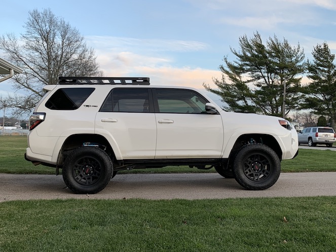

I have 550's, set at approx 2-2.25" over stock, rear eibach 1" spring
- Year, model: 2018 TRD Pro
- KDSS: no
- Spring rate: 650
- Preload: 0 on both sides
- Height increase: Not sure yet. Will update after breaking in
- Changes that you have made in preload or spring rate and why: none yet. Just installed
- A brief set of notes with your thoughts on your setup: Ride height is perfect for me after install. I also installed the icon 2" rear springs. I took it around the block to test it out on the speed bumps. It feels good and not harsh at all
