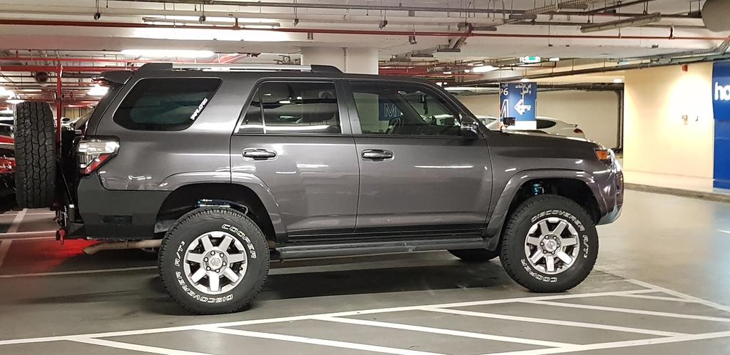

- Year, model: 2016
- Compression Adjusters: no
- KDSS: yes, no lean
- Spring rate: 650lb
- Preload: none
- Height increase: 22" (2" lift), Rear is 24" (OME 2889 medium load)
- Major weight upgrades: aluminum skids, steel sliders, 510lbs of weights in back (estimated camping gear and passenger loads)
- Changes that you have made in preload or spring rate and why: I'm on this thread to figure that out.
- A brief set of notes with your thoughts on your setup: love the feel. Plush but firm and confident.

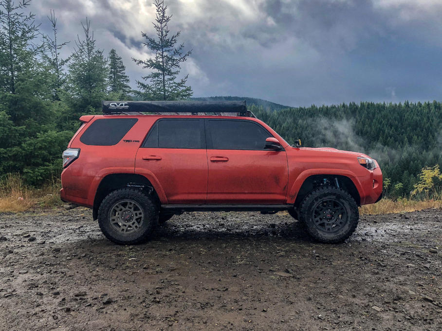

- Year, model: 2016
- Compression Adjusters: yes, extended travel shocks
- KDSS: yes, no lean prior to install.. some lean afterwards
- Preload: none, except for few threads on pass. side to correct lean
- Height increase: ~3" lift, Rear is on Icon 3" Overland dual rate springs
- Major weight upgrades: aluminum TRD skid, rear full SSO bumper w/ spare tire, dual battery setup in engine bay
- Changes that you have made in preload or spring rate and why: zero pre-load got me exactly to me desired lift luckily.. cranked a few threads to correct the KDSS lean - passenger side (pic below). Went up on spring rate to match rear coil characteristics and have some headroom for bumper/ winch later.
- A brief set of notes with your thoughts on your setup: Ride is firm and confident, but not harsh. However, if you never plan on adding weight up front, go lower on spring rate for softer ride. Fronts are at currently almost always at full soft and rears are cranked 18 clicks to control the weight.

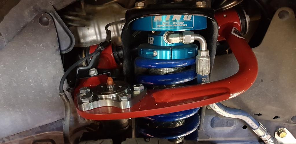

- 2015 Bro
- Compression Adjusters: Yes. Drove some washboard roads on fully firm and fully soft, ended up setting them 8 clicks from softest on front and 6 from softest in rear.
- KDSS: Nope.
- Spring rate: King standard springs in front, swapped out my SAW 1.5 for Toytec Superflex 2" in the rear.
- Preload: 8 threads on both sides.
- Height increase: 3" in front, almost 4" in the rear but they should settle down a bit for the very slight rake that I'm hoping for.
- Major weight upgrades: Gobi rack, 4x4 labs sliders.
- Changes that you have made in preload or spring rate and why: None yet.
- I was a little bit worried that all of the amazing feedback on kings was hyperbole by people trying to justify the cost, but I just spent a few hours driving around in the woods and I get it now. Didn't want to stop driving! I drove roads that I am very familiar with so that I could make a fair comparison. They really seem to shine on washboard and rutted out roads; the same roads I would normally not go over 25mph without skittering and losing control I was able to go 40+ with total confidence (Yeah duh that's what they are designed to do, I just couldn't believe how well they do it). Really happy with this setup!

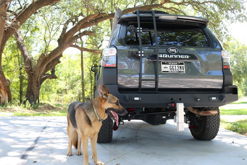

- 2015 Trail no KDSS
- 25001-278-EXT-A: front ext travel w adjusters and 550 lb x 14" coils (adjusters at 2 clicks from soft)
- 25001-279-EXT-A: rear ext travel w adjusters and Dobinson's C59-677V 3"+ coils (adjusters at 2 clicks from soft)
- Preload: D=12 & P=10
- Height increase: Front 23" D&P (3" increase over stock at 20") - Rear 25" D&P (3.5" increase over stock at 21.5")
- Major weight upgrades: Aluminum front bumper (60 lbs) w/ 10K winch (90 lbs), Aluminum rear bumper (80 lbs) Aluminum Full Skids (100 lbs), steel sliders (160 lbs), steel roof rack (80 lbs), misc (+/- 130 lbs) = +/- 700 lbs
- comments based on previous suspension iterations: stock > Bilstein 5100's > Toytec ultimate w/ superflex:
1) HWY (285 KO2 @ 40-42 psi) comfortable and controlled with front/rear sway bars intact at 60-80 mph. feels planted to the ground, best adjective i can think of is it "glides" over even rough/dippy hwy terrain with improved damping (less bounce/roll)
2) City & CR (285 KO2 @ 40-42 psi) a lot of time at 50-60 mpg on curvy/rutted 2 lane roads in central TX, confidence in handling greatly improved from prev setups. significantly less (still mildly noticeable) cabin shake & steering vibration in washboard areas even with tires at full pressure
3) Off-road: (285 KO2 @ 16-18 psi): will hold comments and update after future fun times, haven't gotten to play enough yet :( too much rain and not a big muddin' guy ha. i think i will remove at least the rear sway bar on my next outing
4) Towing: Airstream Bambi Sport (cute name right?): 16'/3K lb trailer 350 lb tongue weight without weight distribution system or rear airbags. it is a relatively light load to haul and is almost easy to forget is behind you. basically, i have to remind myself to drive easy so as not to abuse Bambi. minimal static sag in the rear (approx .75")

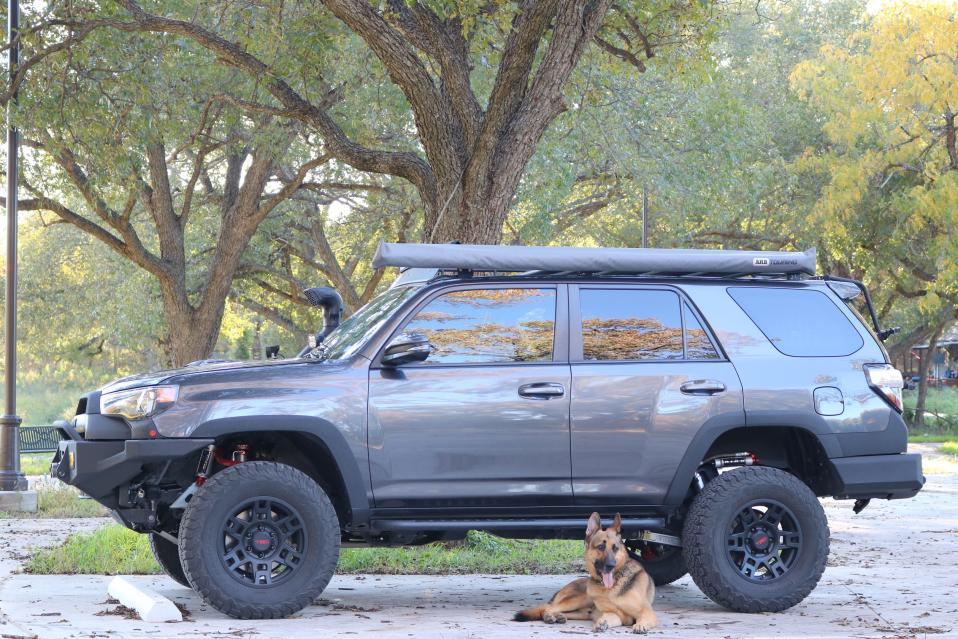

Rig looks good, but I love your Shepard!

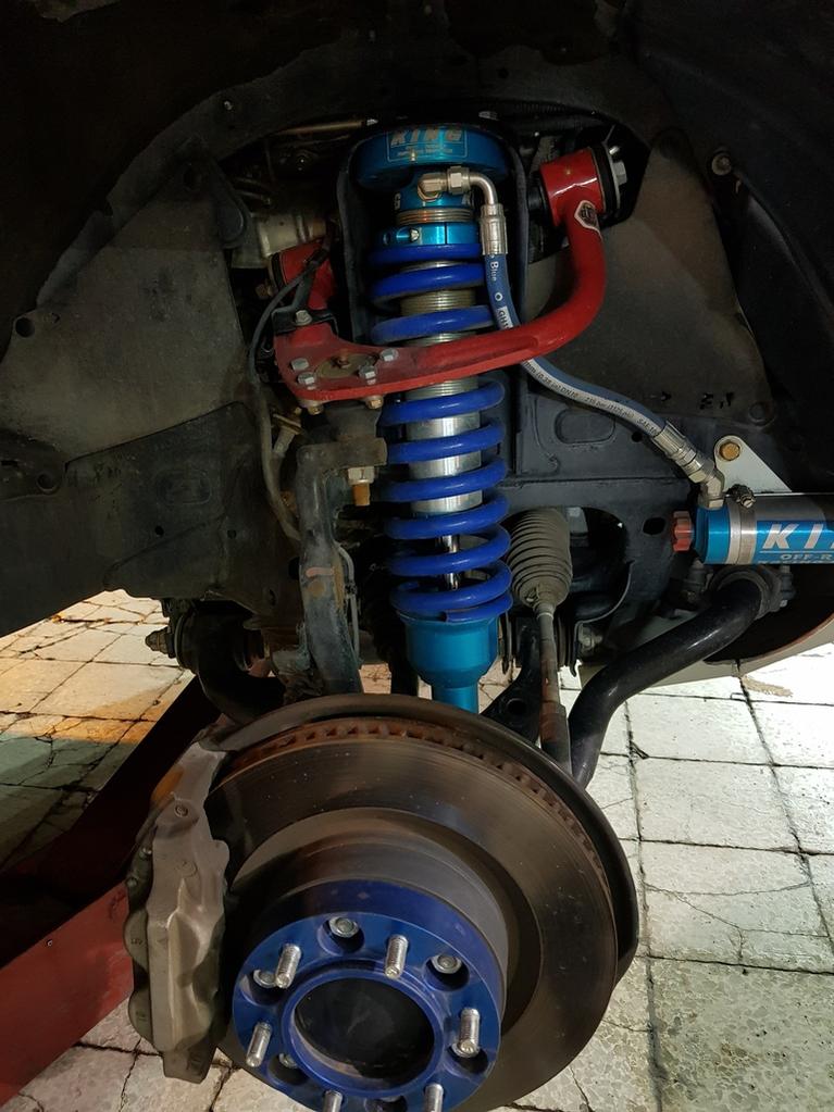

- Year, model: 2016 with KDSS
- KDSS: Yes, No Lean
- Spring rate: 550
- Preload: 7 Threads Both Sides
- Height increase: 23" Post lift after settling 22.5"
- Major weight upgrades: None
- Changes that you have made in preload or spring rate and why: Nope its perfect
- A brief set of notes with your thoughts on your setup: (firmness, ride height, Think its perfect
I have only installed the front so far.
I have Eibach Pro Lift 1" rear springs and King shocks for the rear that I will install later this month (this is not my daily)
