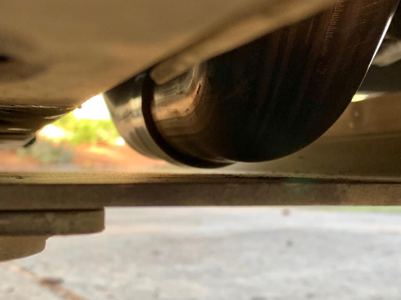

Hmmm. Your pics and comment worry me. I literally bought this to have more clearance between my skid and Y pipe. It looks pretty low and that hanger bent down looks like it for sure hit the skid. I told Jason a few times why I wanted it and he said it will work and be good and I trust him, but I guess I’ll find out! Was supposed to arrive today but apparently fedex lost my package so I’ll have to wait.
I think the hanger might sit just outside of the width covered by a skid and I'm not saying they'll rub a skid just that it looks tight. Maybe transfer skids sit lower than I expect? I don't have one. I can look at my buddies gx skid and tell you for sure I just wanted to highlight a concern over a question I've been asked a couple times to confirm.

Now, the most important for me was clearance. It’s why I bought this. My oem one rubbed on my RCI skid plate. This one has MAYBE 1/8” more clearance. Does it rub.....no. Is it what I expected when I ordered....no. I thought it would have a little more clearance based off what I was told, but it was brand new and no one had installed one with a RCI plate yet to find out. I guess I was kinda the test dummy haha.
If your buying this for extra clearance or you have RCI transfer case skid then this is NOT the Y pipe for you. Go with the URD Y pipe. I have spacers in my skid to get the clearance to not rub. If I had more motivation I would send this back or argue for a refund, but I don’t feel like dealing with that and taking it back off and reinstalling oem one.
Summery: Does not have more clearance, if you have transfer case skid this is not really compatible unless you run spacers to push the skid lower. The hanger bracket it not good if you actually off-road, it points down. It will get caught. Imma cut it back. Oem gaskets don’t work very well with out a fight to seal. Fitment is good, quality is good. Power.....definitely more in the top end but otherwise can’t tell difference.
