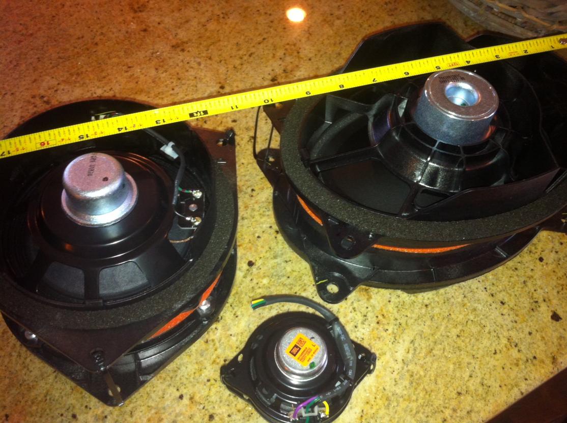

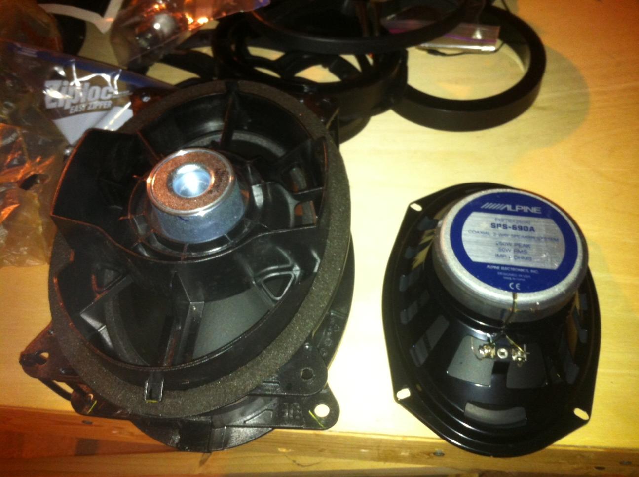

picture of factory jbl speakers
I just did a system upgrade and wanted to post some pictures of the factory speakers. For a "premium" system they seem pretty lightweight.
In one of the pictures I put the speaker against an Alpine aftermarket 6x9 to give a comparison. You can see a big difference in magnet size. Not sure about newer speakers but back in the day you needed a big magnet to drive powerful speakers.
