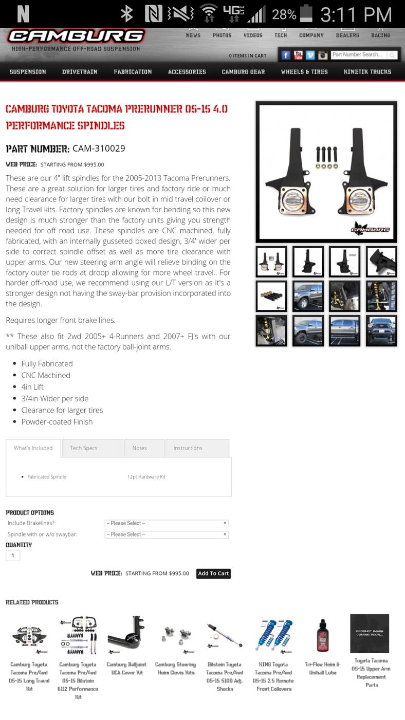

uploadfromtaptalk1455577984193.jpg Any 2wd people out there running the camburg or other manufactured lift spindles ? If so what UCA are you running and if it's ball joint or uniball. I noticed on camburgs website that if you run the lift spindles on the 4runner's, it's only compatible with there uniball UCA. Any input why we 4runners can't just run the camburg ball joint arms, Tacoma's can ?

sorry, missed your question after the large photo.... not sure why the wouldnt be compatible with BJ arms. i know when i mounted a set on my 05 tacoma, i used the tacoma OEM UCA due to the fact that i ran DR at 1" lift, for a total of 5" up front.
EDIT: i know there is a slight difference between the tacoma and 4runner/FJ OD on the BJs, maybe the shaft is different enought to not be compatible? probably best to call camburg themselves.
check out the maxtrax spindles, they are half the price. I had a set of these back in the day on my 05 tacoma prerunner when i lived in socal and it was either these or the TC $1,250 ones. i agree with above, the powdercoating (at least back 7 years ago) was a lot to be desired and i remember i had to chase all 4 hub threads to ensure i could properly screw in the bolts without galling or crossthreading. i also remember there was something to do with the ABS sensor as liqourish mentioned.
remember, 4" lift spindles will only work on 2wd truck. this is due the shifting in the mounting point such that the lower ball joint mount is right in the way of the front CVs on a 4wd.
Total Chaos as well as Max Trac suspension make 4" lift spindles. If you plan on off roading, only run the Total Chaos. If you just want height, no off road, then Max Trac is a good alternative.
Total Chaos sells for factory (balljoints taper) and for aftermarket (uniball) upper arms.

i think tin is running maxtrac like me and they are pretty solid. there is a different taper in the spindle for a tacoma ball joint and fj/4runner ball joint. i contacted maxtrac and they have different part numbers for each spindle. there probably is no taper and heavy duty bolt because of the 1.25 ball joint. But, I'm wondering why you would get a camburg spindle and want to run oem ball joint?

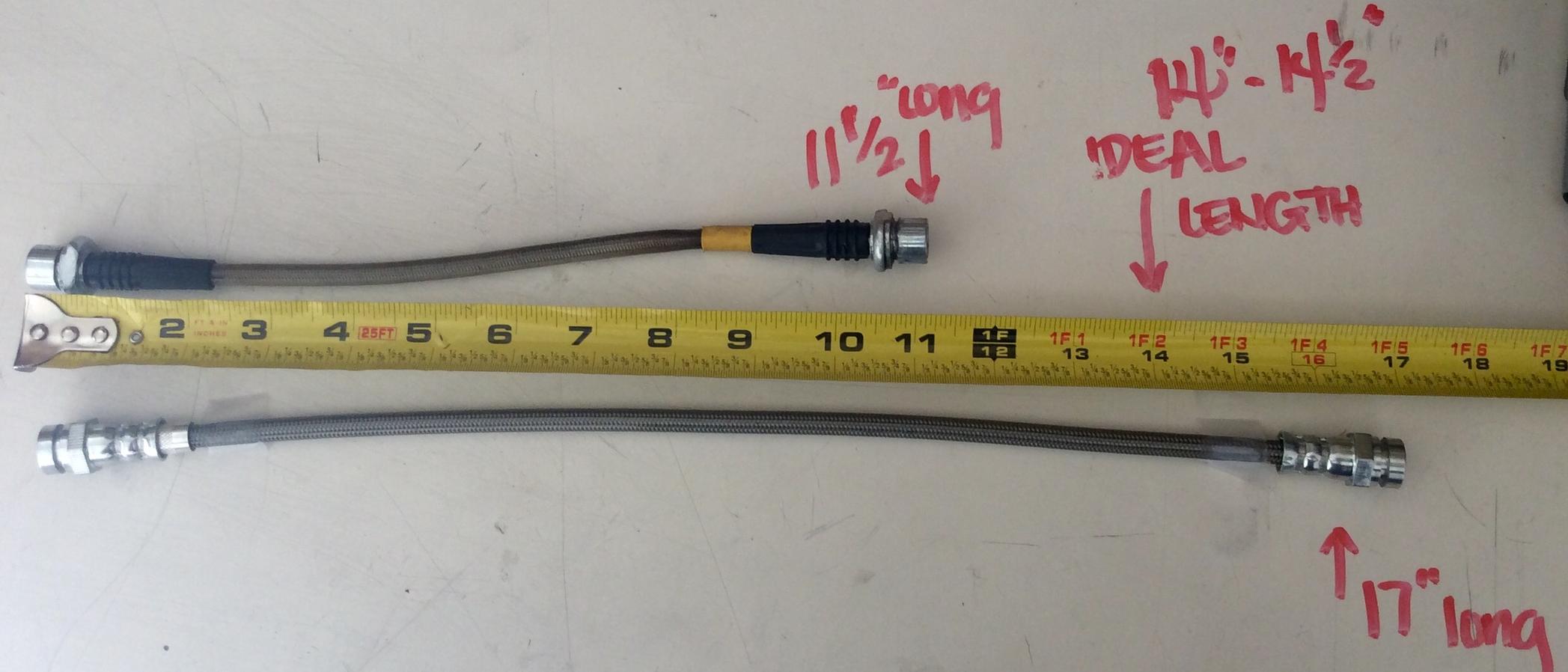

Pic of stock length ss brake line and ss 17" brake line that comes with 4" lift spindles. You can decide ...
