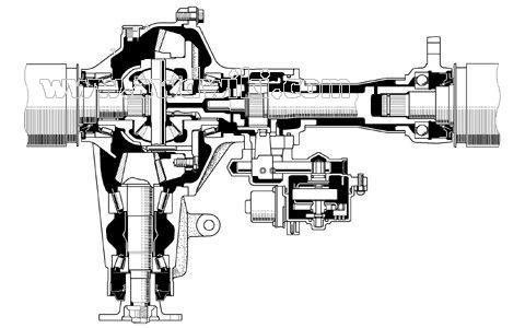

No, the front diff still rotates with wheel movement, the axles are directly connected. The disengagement point is near the pinion flange (where the front driveshaft bolts to the front differential), meaning that input from the transfer case is disconnected.
Actually, only the side (spider) gears within the differential turn whenever the vehicle is moving in 2wd, They are driven by the left (driver-side) CV-axle.
The axle disconnect is on the right (passenger) side of the differential housing. As seen in the diagram below.
