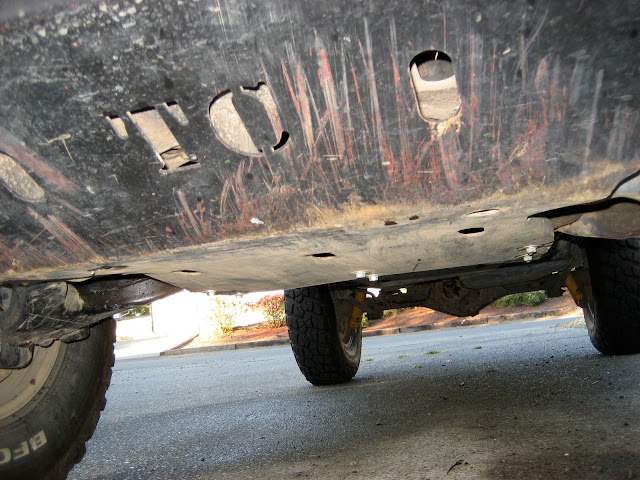

Easiest way to avoid a mess is to pull off the skid-plates, so when you are in the wheel well, you don't get dirty and the oil actually goes into the pan :thumb3:
Also, Toyota filters and royal purple all the way
Sure, until you get it on your rotor and your left wheel doesnt feel like stopping so well. :flipoff:
EltonH, I share your sentiment. I thought I was alone on that. And if somebody is getting oil on the brakes during an oil change, perhaps that somebody should be paying for their oil change to be done for them.
No, shit? :thumb3: Oil in the pan is not the problem, it's the oil that gets all over the frame and lower control arm that's annoying.:flipoff:
