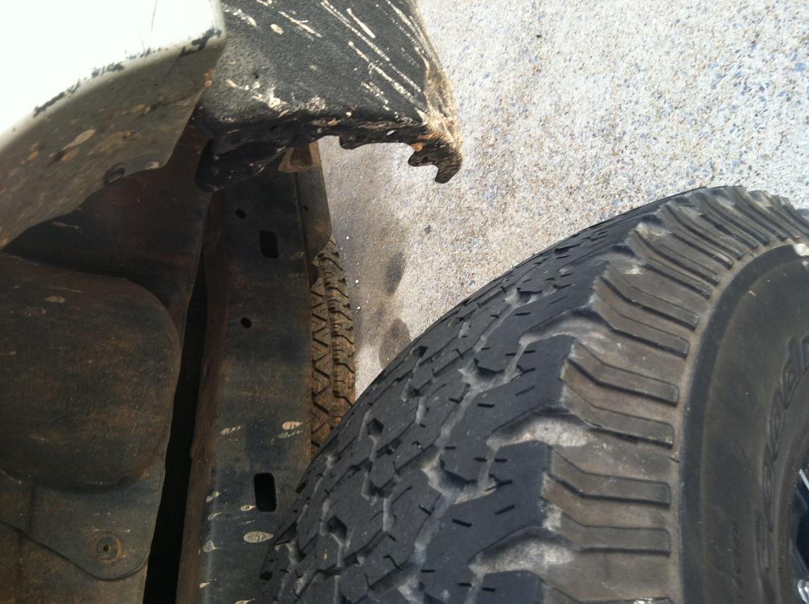

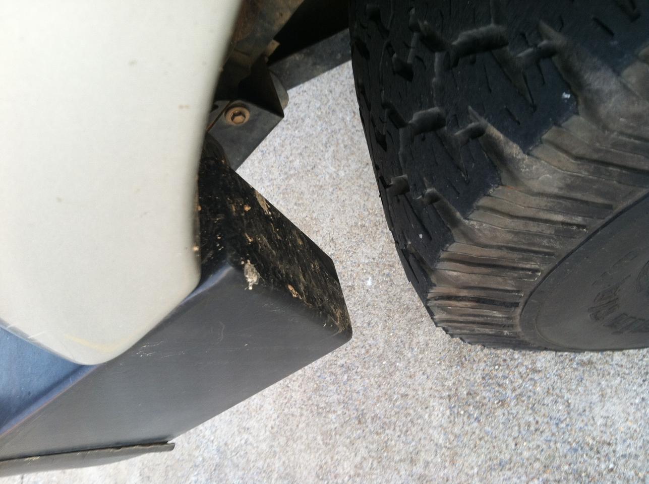

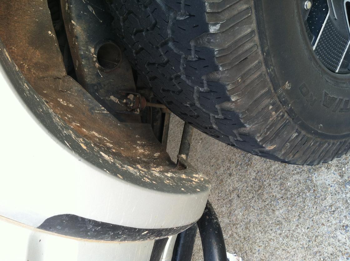

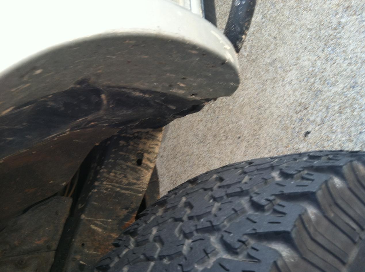

I am currently running 305/70/16 with a 3in suspension lift, no spacers, and no body lift. Would it be possible to fit 315s with only a little rubbing? Pics of the space with 305 below. thanks

i have 3 inch lift with 2 inch body lift, 35's dont rub at all while driving but rub like crazy when off roading and suspension flexes
Might want to swap your rear coils to some 851/861s.. but otherwise, get your BFH ready. You'll also want to remove your rear bumper.
Rear bumper will need cut to have to go. When wheeling you will rub, so cutting the fender and hammering the pinch weld will need to be done.
If you're going to wheel it, you're going to either want to remove the rear bumper, or generously cut/remove the sides.
Why does no one run 295/75/16 they're perfect to be taller than 33s but not run like crazy
That's what I run. They measure at 33.4" and they look great! With the backspace on my wheels I've had to trim the pinch weld area pretty well, so unless your wheels are just perfectly backspaced you're gonna have some hella rub.
