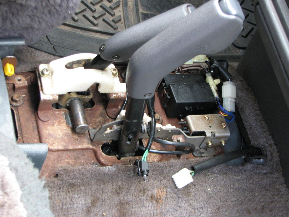

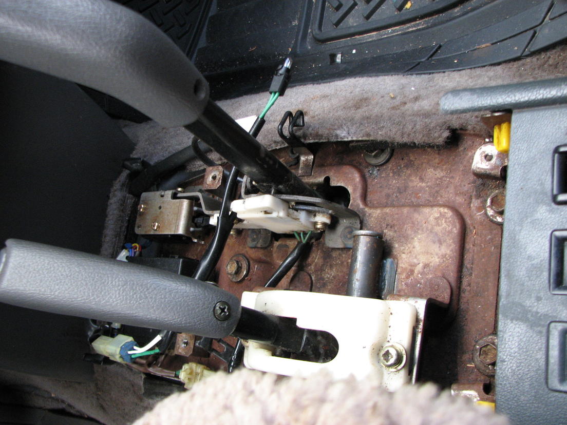

Removed the console and disassembled the gear shifter assemble a few times and found the only way I can get the gear selector and ignition to the lock position, after a fashion, is without the console. Studied for awhile and believe I can reassemble but all depends on whether I can install the shift lever handle with the Shifter Release button to operate properly, believe worn components may be effecting the tolerances??
The shifter lever is too loose and thought I would check with members to determineto see if members aware of any repair kits?
If I remove the 4 screws that secure the unit to the trans tunnel can I left the assembly out without opening a can of worms? Remote possibility of possible replacement but the pic shows there's a lever which I assume attaches to shifting arm(s) on the trans??
Any comments, assistance appreciated!!
