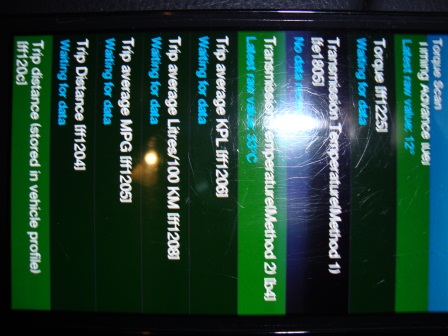

I noticed that my Transmission Temp and Coolant Temp readings are just about the same. Where or at what points (gauges/PIDs) are these readings?
I've also noticed that my Torque app gives me "Trans Temp 3" (not 1 or 2)....
What am I missing?

... Transmission Temp and Coolant Temp readings are just about the same. Where or at what points (gauges/PIDs) are these readings?
What am I missing?
screenshot.jpg~original
I found the transmission temperature fluctuates and is distinct from coolant temperature after driving for some time.

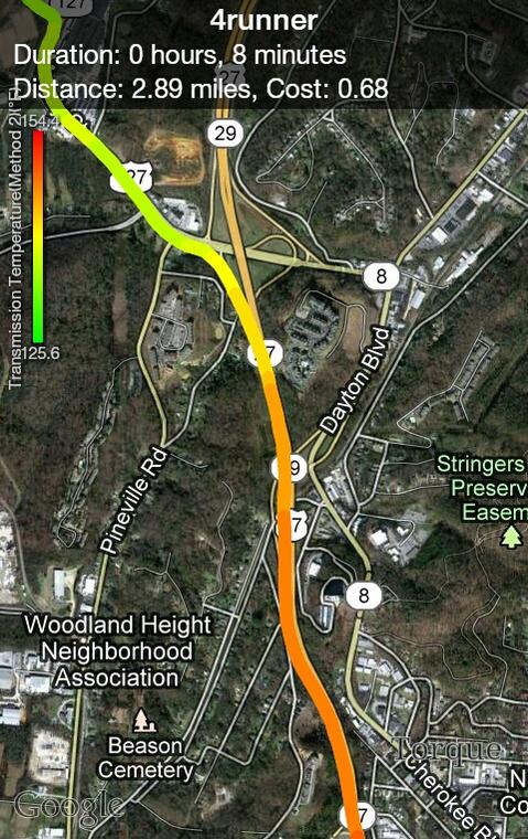

playing around with Torque info
Just posting a graph I made from the Torque information. I initially posted both Trans Temp and Coolant Temp, but my numbers are basically mirror images.

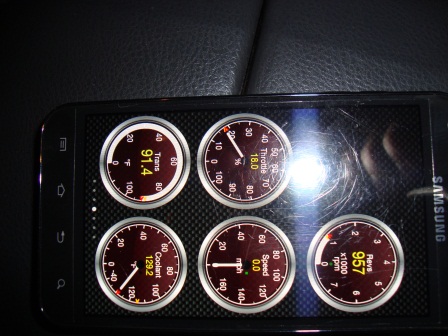

You can set up tiles and have about 9 or 10 different things at once. You can also move between screens, with different tiles, pretty easily. You can see real time info of everything.
You need the pay app though. The free app is just a demo and doesn't give everything. You also need to get the torquescan addon. Did you read the wiki instructions are just fritz with it and move on?
Here are some screen shots. I can literally see everything.
Edit: You can see I can also see instant timing advance. That one I love seeing. I can see a difference between 87 and 89, in terms of how far it advances. On 87, I have seen as much as in the 20's when climbing a hill.
Kinda neat to see.
I was using the free app on a crappy Samsung Exhibit II Android phone from Walmart! LOL
Actually it doesn't look too bad and I could probably display 6 gauges if they are the smallest ones but they would be too small to see unless I just display the numeric values. I don't want to tie up my phone just to read temps though so I got an UltraGauge to use instead.
