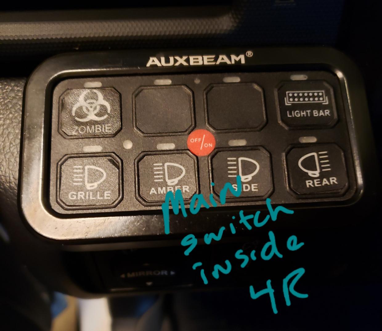

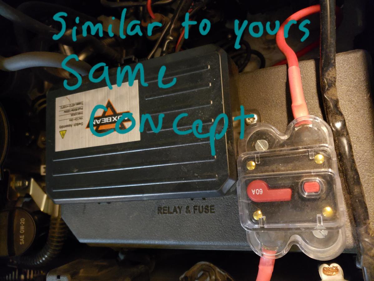

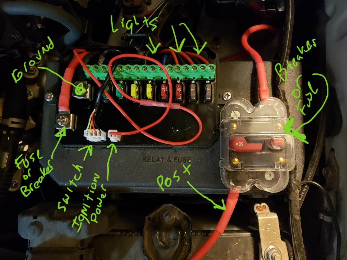

Mine is same, but slightly different, wiring should be same

The Auxbeam control box is a solid-state relay. Like you said, it has relays built into it - you don't need to add relays on top of relays.
If you are using a wiring harness with a built-in relay and switch, the wired relay won't engage and allow current flow unless the switch is flipped. If you cut off the switch, the only way that relay will engage is if you apply 12V across the leads.
My suggestion would be to cut the relay off of your wiring harnesses and run wires directly from the lights to the Auxbeam terminals. There should only be two wires running to and from your lights to the + and - terminals on the Auxbeam control box.
IIRC, blue and white wires are generally used for switches... are you trying to connect your switch leads, that you had cut, to the Auxbeam? It almost looks like you are possibly running the leads from the lights to your battery and wiring the cut-off switch wires to the Auxbeam.

Is it possible to rewire the auxbeam switch panel to separate rocker switches? I have the 8 gang auxbeam one but i dont want to use the bulky panel. There is a 4 pin connector with red/black/green/blue wires
