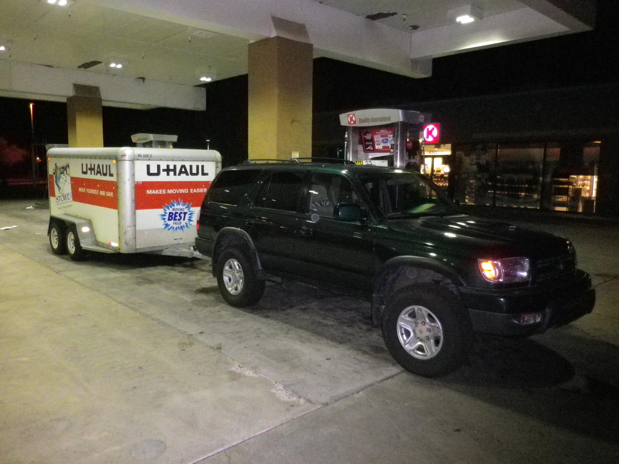

I disagree. I towed a loaded 6X12 closed U Haul trailer from Phoenix, AZ to Seattle, WA last December. Truck never skipped a beat. I actually have to relocate back to AZ next month and will be using this same setup. It is no monster but with the trans cooler and careful driving it does fine.

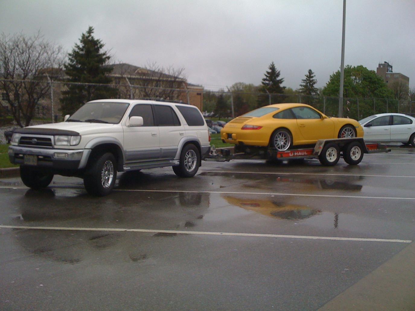

Car and trailer was close to the 5k limit.
COG on that load seems awfully far forward. Not surprised it's weighed down. Max. tongue load is only 500lbs.
