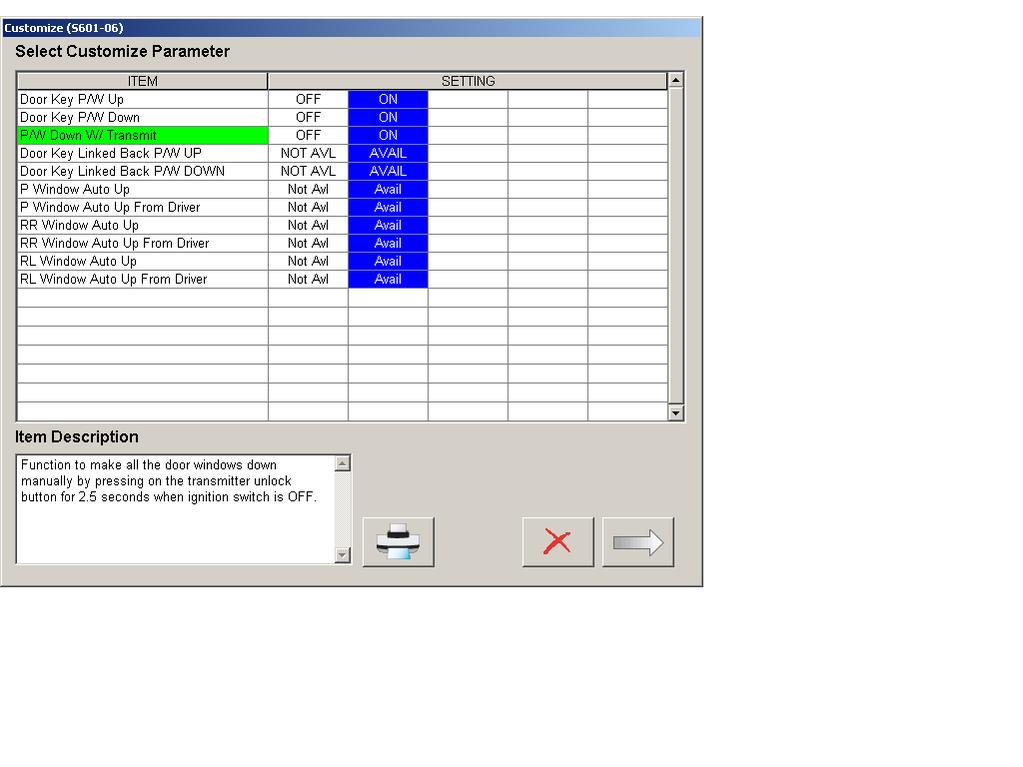

Here's what the page looks like in Techstream. There's another option where sorta seems to suggest that the back window should go down with the remote but I haven't been able to get it to work.

You can have the dealer or Carista program in to where you stick the key into the front doors, hold to lock and rolls up all windows.
Can also program hold key in on unlock and rolls down windows.
