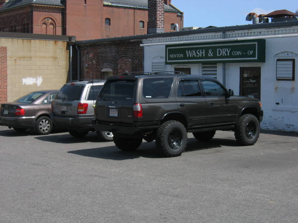

I just got my 4runner about one month ago and I want to lift it up. I don't know what type of lift I should buy or how much I want to raise it. I have seen a couple pictures of rides that are lifted and I want to lift mine to about the same height. I have attached two pictures about the rides I am talking about.
What companies would you recommend for the lift? Someone told me that there are two different types of lifts, a body lift, and a ___?
I do not plan to take my ride seriously off-roading but I do take my car to the mountains and I drive over some rough terrain once there. There are these hot springs up at mammoth and the road to get to them is pretty rough. That is about the only time I will need my car to be raised.
Could you guys tell me the costs and benefits of lifting the ride up. Does the ride quality go down? Do you have a greater probability of receiving tickets?
How big of tires and wheels would I need to buy in order to complete the look? How much would a lift kit cost me? Are there any websites that you can show me so that I can learn more about this inquiry.

After reading a little bit about the subject it seems that I will only need a body lift. Can you guys suggest a good brand that I could buy.

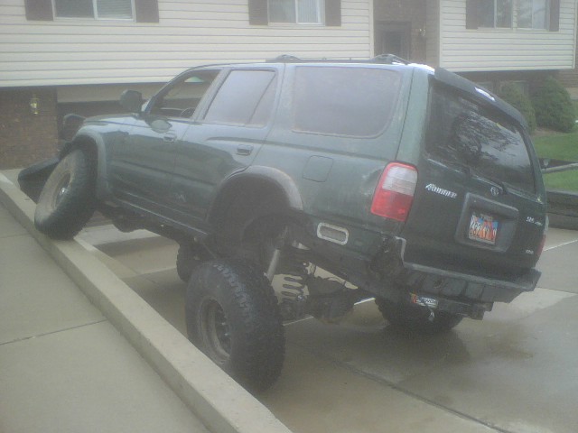

Probably lifted about 4 or 5 inches. Left rear is still on the ground - right rear is rubbing stuff:)
prob lifted more than that, entire suspension has been reworked and a solid axle swap has been done... this is the culmination of about 3-6k worth of work... not a 650$ or even 1500$ suspension lift
