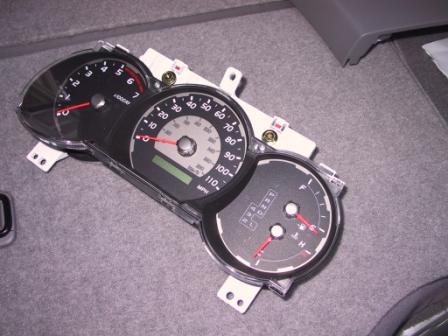

Here is a picture I took of the cluster when I last had it out (about 7yrs ago). I see a couple of silver screws that look like they allow you to remove the cover though I'm not sure why you'd ever need to clean it from the inside. I think you need to remove the lower dash trim, steering column trim and cluster trim to get access to it -- nothing you couldn't do in 30mins or less.

I forgot where but someone had posted a part number for just the clear plastic cover, honestly I've gotten slightly annoyed by my scratched up one and may replace it in the near future if I ever feel like tearing into the dash.
83852-35E50 is the partno for 2008 (07.2007-) 4runner plastic cover
