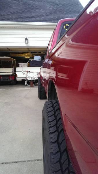

I’ve been running 285/70/17s on factory wheels with 1.25” spacers long before I put my JBAs on. I don’t have a drop of rub anywhere
I’ve been running 285/70/17s on factory wheels long before I put my JBAs on. I don’t have a drop of rub anywhere

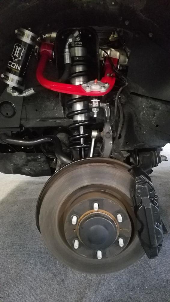

Im in the JBA fan club too! ABSOLUTELY EXCELLENT customer service, well constructed, awesome red, and a common reliable ball joint. The washers during install will make you a little insane and likely require an extra set of hands but definitely worth it!
I am running Icon Rebounds, Spidertraxx 1.25s and 285/70 with no rub (did do a BMC but that's not UCA related)
