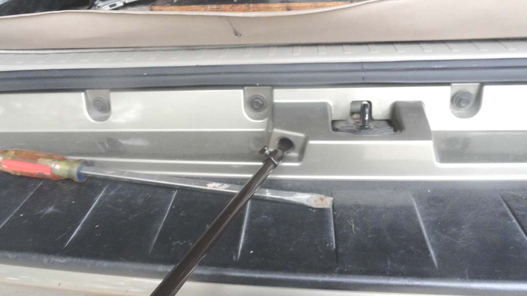

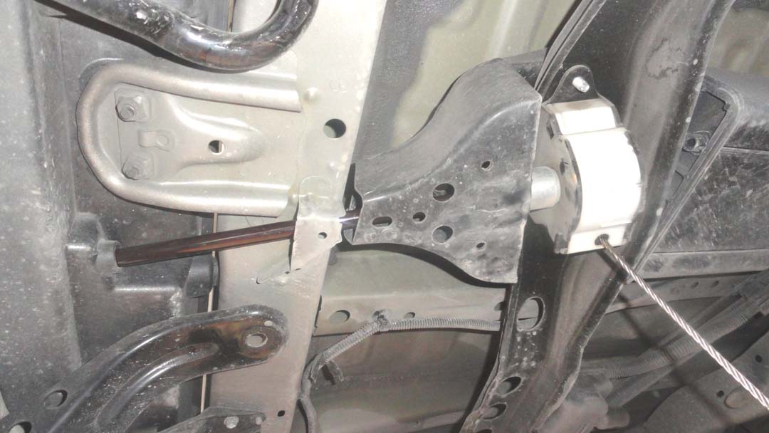

W/O the spare the mechanics on my 07, V6 looks like the attachment. I have seen post that referred to restriction due to rust issues (related to areas where salt etc causes rusting issues). I wonder if rust or etc is blocking “Your Hole”? I would suggest lightly bumping the Hole with the extension or a long screw driver in diagonal corners by feel. To try and locate and get inserted or enough traction to lower the spare (to inspect/work the Hole closer if you feel rust is an issue). Meanwhile we’ll come up with a better term vs Hole (Spot, Insert, Socket), “Receiver”!!!

I like "hole"!!!!!! But seriously, I was also wondering if it is a rust issue as well, the vehicle is originally from Chicago, and it has some rusty screws and clamps. I will try tapping inside the hole and even spraying some WD-40/PB blaster. I would just hate to be stuck somewhere and can't get the spare down.
I’ll suggest you get a section of 3/8” or ½” round steel related to the extension’s size. Gind it about 3/4” from the end to a point, leaving it square as you grind from the end. Hammering lightly, this might go in and give you enough traction to get the spare down. There was a related post on this matter 6 mo to a yr ago. That was able to get the spare down for the maintenance w/o cutting the cable or drilling to rem. Good luck, Lub Helps! LOL.
insert the tire release mechanism...only the first joint, spray wd40/mystery oil or any good fluid down the pipe 'hole' that shud direct the fluid to the exact spot, and prolly free it up
