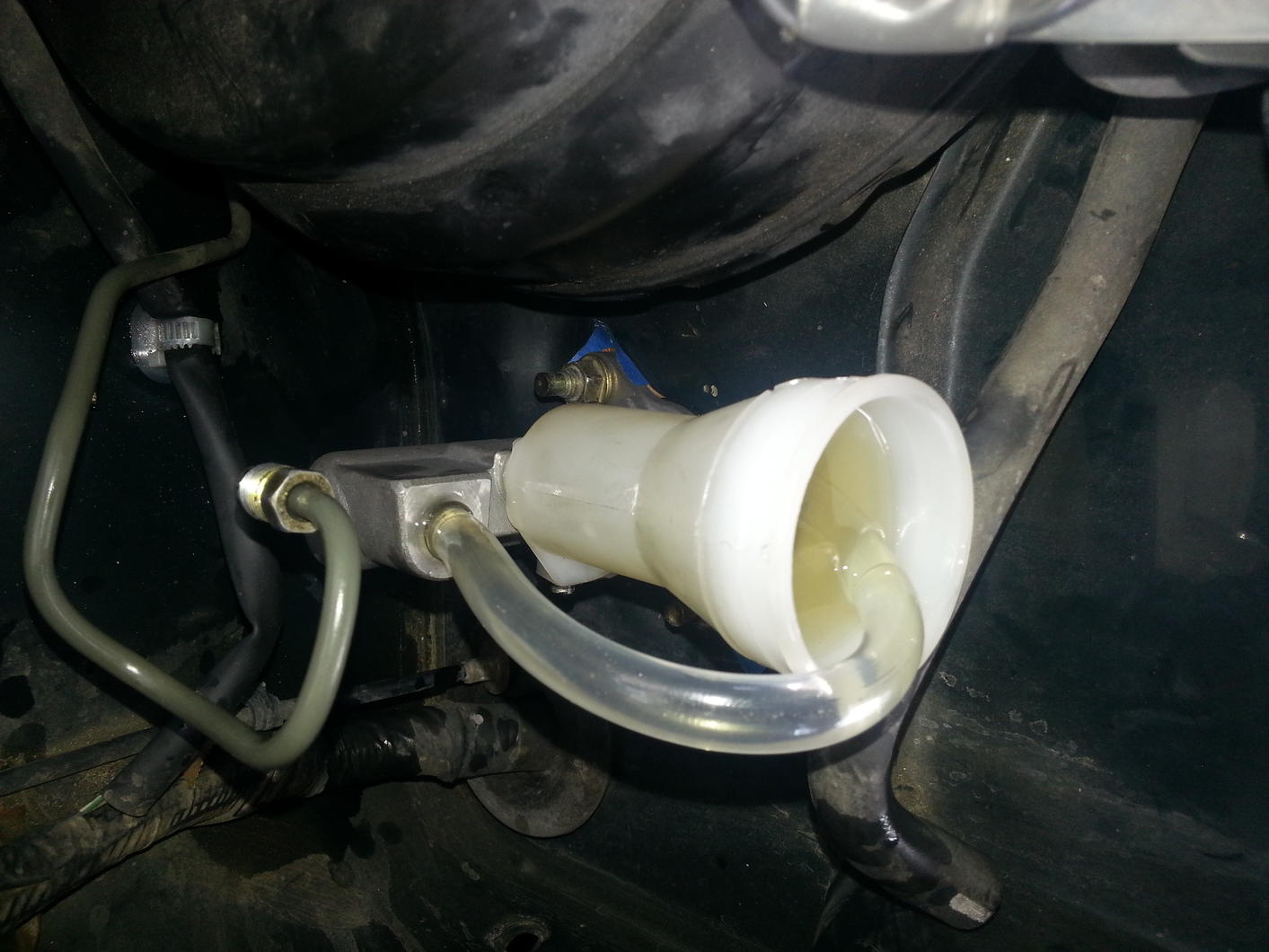

So I did this bench bleed and everything looks good. Then connected the line as quickly as possible.
If I pump the clutch pedal 20 times, then manually move the slave pushrod a few times and open the bleed valve only a little fluid comes out.
