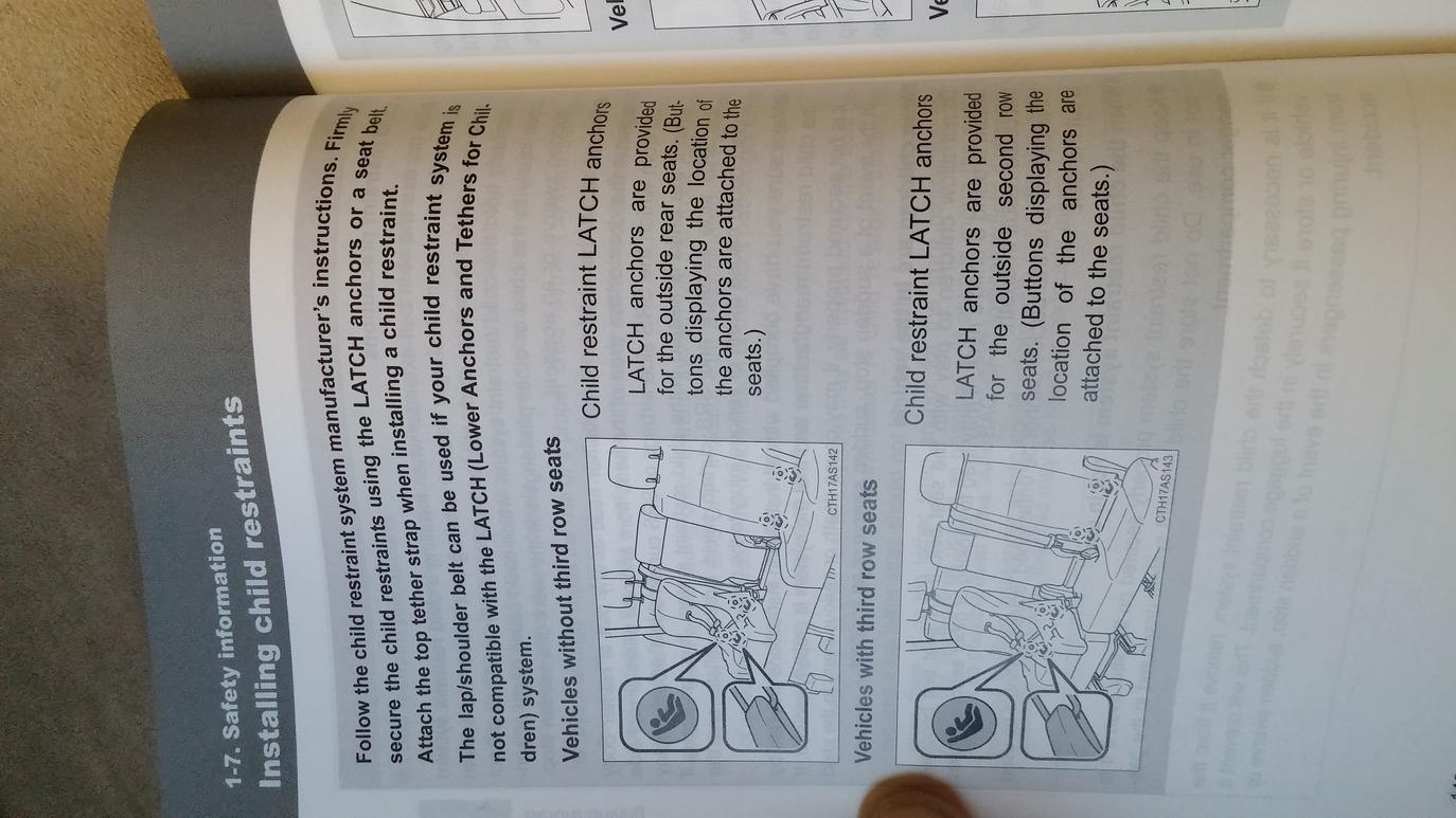

My 2013 owners manual does not specifially say the lower anchors/tether can be used for the middle position. It just says "LATCH anchors are provided for the outside rear seats". While my latch strap is long enough to reach, im hesitant to install with that method if the owners manual doesnt make mention of it.
While it would "probably" be fine, I would just stick with the seatbelt in the center position if it were me. There's no interpretation needed to know it works and is approved. But take the time to learn how to correctly install it yourself and by all means go get a second opinion from a CPST who can go over the install with you.
