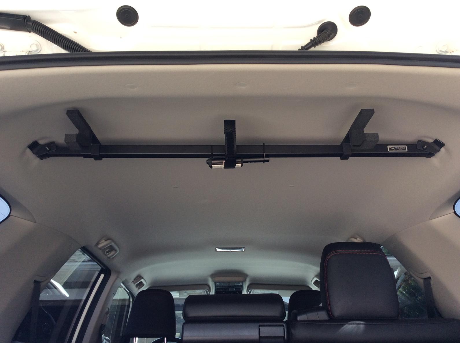

I did this, because I'm tired of that being under my back seat, and it's way more accessible on those back country camping trips when it's just inside the rear glass and not under a pile of shit.
Not going to argue the legality of it, I don't really care, but if anyone else is looking for a way to mount theirs...

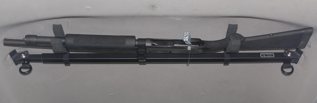

This is a disposable shotgun (NEF Pardner Protector, bought it for $100 used, clone of the 870) in a Big Sky Racks SBR-1 ($57.00 at Cabelas). Big Sky also makes an SBR-2 which holds two guns. I actually bought the SBR-2 because they were out of the SBR-1, but I simply didn't add the extra clamps on the back side for the second gun so this is basically the SBR-1.
The rack is very stout, nicely finished aluminum. If you look at the link, you will see that there is a padded middle section with a velcro band that is designed to secure the gun, I opted not to install that in the interests of keeping this nice and trim to the headliner. I have a fastex buckle holding the gun in and will use a short length of braided wire / cable lock to secure the gun against theft as needed. You could also build a aluminum lock assembly using aluminum plate and a clevis pin (see old pic, below).
By placing it here I was able to maximize two features: first, no drilling required. Just remove the coat hooks and bolt this up in their place. Second, it's accessible without opening the hatch if you roll the window down.

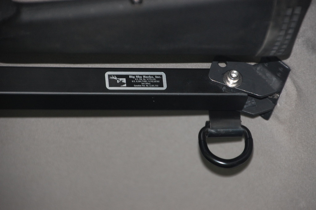

I replaced the factory bolts with M6 x 25 button head cap bolts and star washers:
Alternative locking idea, from my old Xterra:

I ended up flipping the shotgun 180 deg on its axis, so the sights face the front of the truck and the loading gate faces the back. The gun is more secure and tighter to the rack that way. It's working out great, even on off road stuff.

Do gun racks and cargo attics not tear the shit out of the felt headliner? I feel like every time i accidently rub mine loading cargo it leaves a mark.
Not really. Once mounted the rack doesn't move so there's no wear. The muzzle of my shotgun is wearing a black mark into the edge of the headliner, but that's because it is a snug fit and rubs. I really don't care- it's there for a purpose.

I added the FJ Cruiser D rings that I had lying around from an earlier mod to the Big Sky Rack (part number 58460-350120):

Just to clarify, the part number above is for the D rings only. The rack itself is Big Sky Racks model SBR-1 (SBR « Big Sky Racks)

I removed the cable lock and installed a better lock made from aluminum flat stock, 1/4" bolts and nuts, a 1/2" clevis, and a padlock. Clevis goes in from the bottom and drops out when the padlock is unlocked. This is substantially similar to my old Xterra lock which is pictured in the post that the OP pulled from another thread, above.
I didn't pad the aluminum because the gun is a beater and I don't care if it gets beat up, but for a nice gun the aluminum needs to be covered for scratch protection.

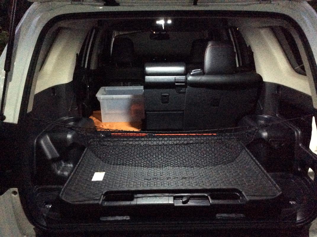

Got mine installed, very solid utilizing factory holes. Added a 250 lumen led work light to solve the lack of cargo area lights.
