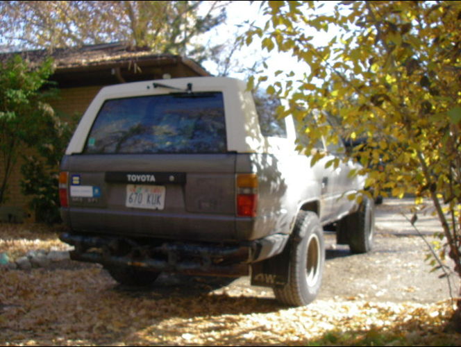

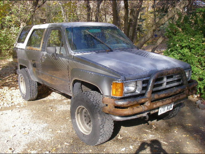

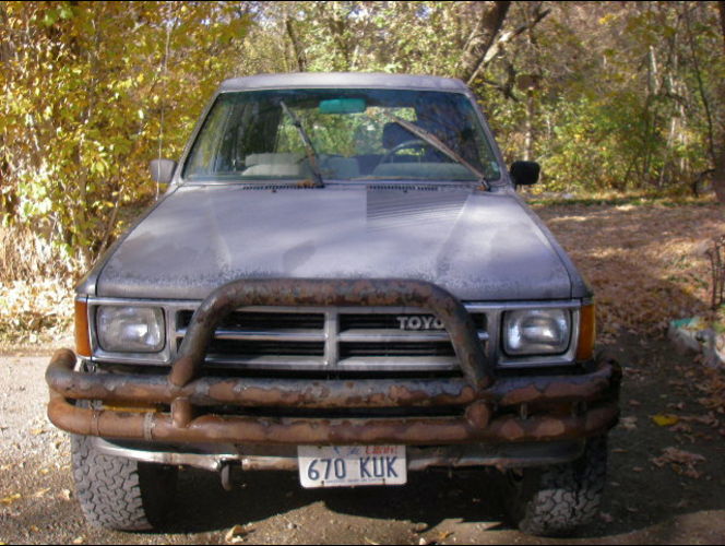

1987 Toyota 4Runner SR5 22RE. I bought it for $975 with 218600 miles on it. For all I know it was stock. The previous owner put in an aftermarket security system and cruise control, but I don't know how to work either of them. The rear window works with the key! Had a bad exhaust leak where the manifold connects to the block. The transmission is a little thrashed. You have to hold it in 1st or else it will kick it out of gear when you let off the gas. All other gears are good. 4WD works awesome! Has auto-locking hubs so no need to get out and twist them :) It had two super bald 31x10.5 BFGoodrich All-Terrains on the front, 1 BFG with good tread on the driver side rear, and 1 Pathfinder I think it was on the passenger side rear. I think that's about it for now. These are pictures from the ad I saw on ksl.com where I bought it

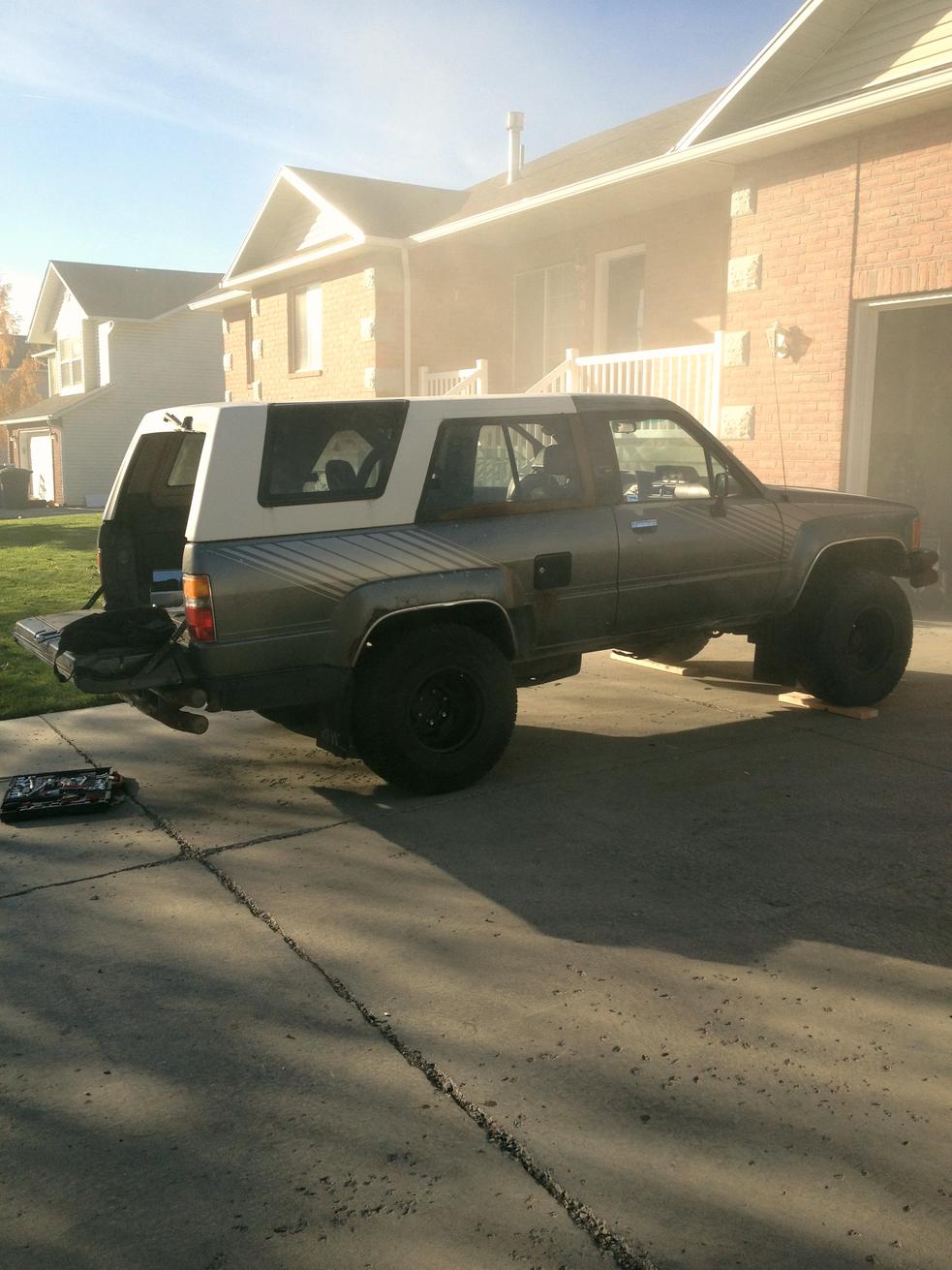

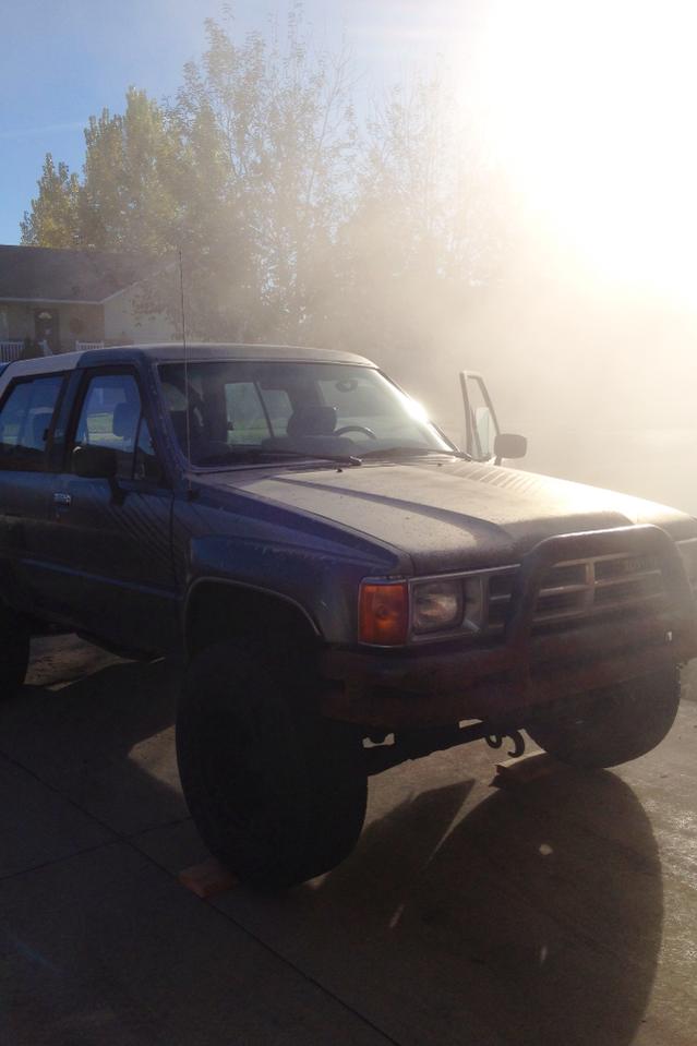

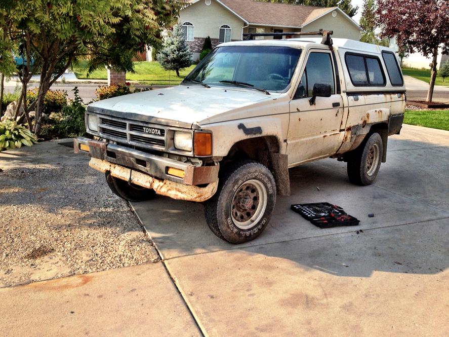

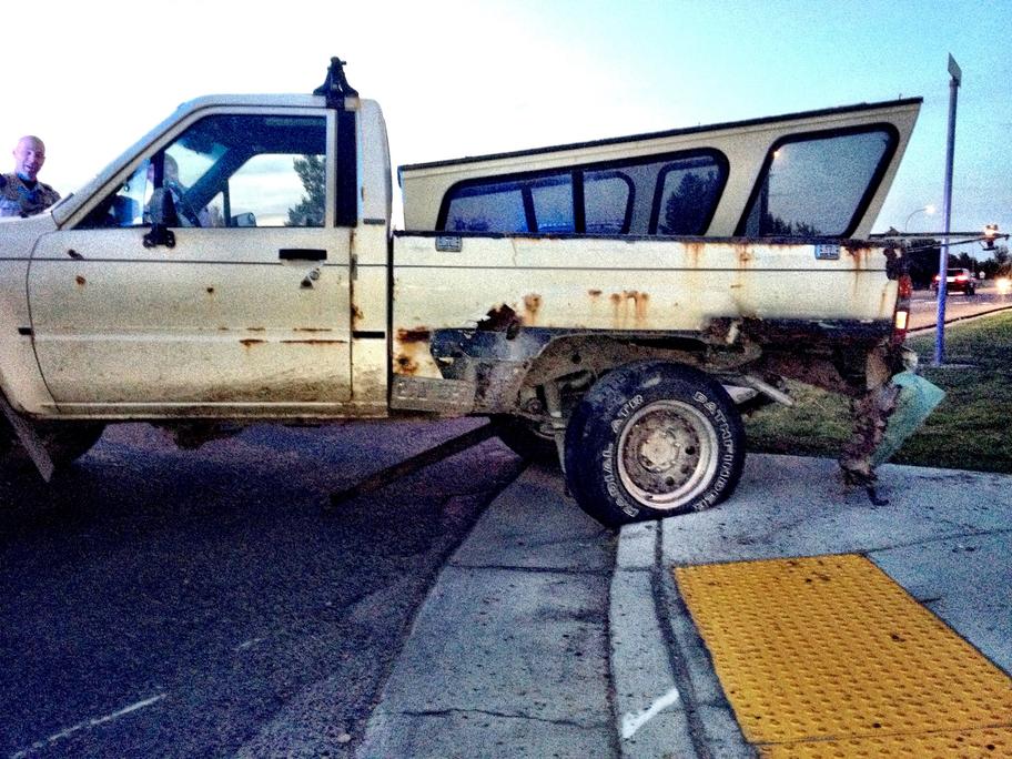

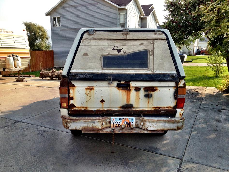

So a few months before I got this runner, I had an 87 Pickup 22R that I got from my grandpa. It was a puny little thing so I wanted to put some bigger tire on it. My girlfriend's dad gave me some rims he had and I picked up 5 Big O Big Foot tires for $300 with about 90% tread. I wanted black rims so I plasti-dipped the rims before mounting them. (bad idea) I had to get the tires mounted and balanced on the rims but in the time I was getting that done, I got t-boned by a high school student and totaled my truck. I bought my current 4Runner with the insurance money and got the tires all mounted up. Sure enough, the plasi-dip got torn up along the edges of the rims so I re-did them and they looked good. But that is the first thing I did to my runner was rims and tires.

This is after I got the tires and rims on.

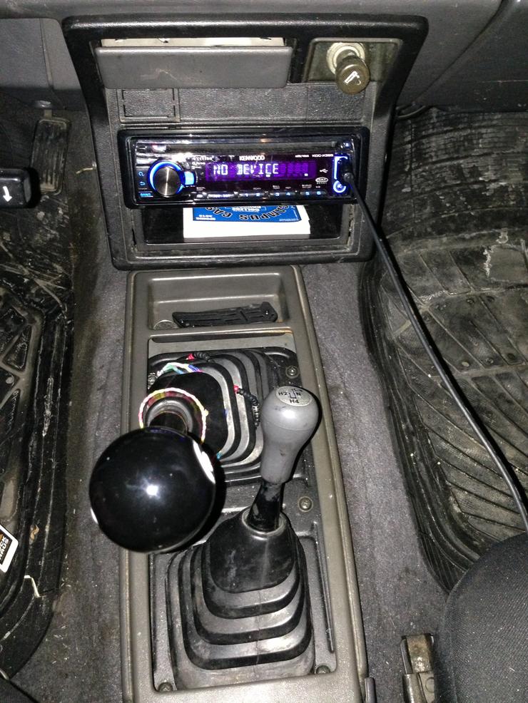

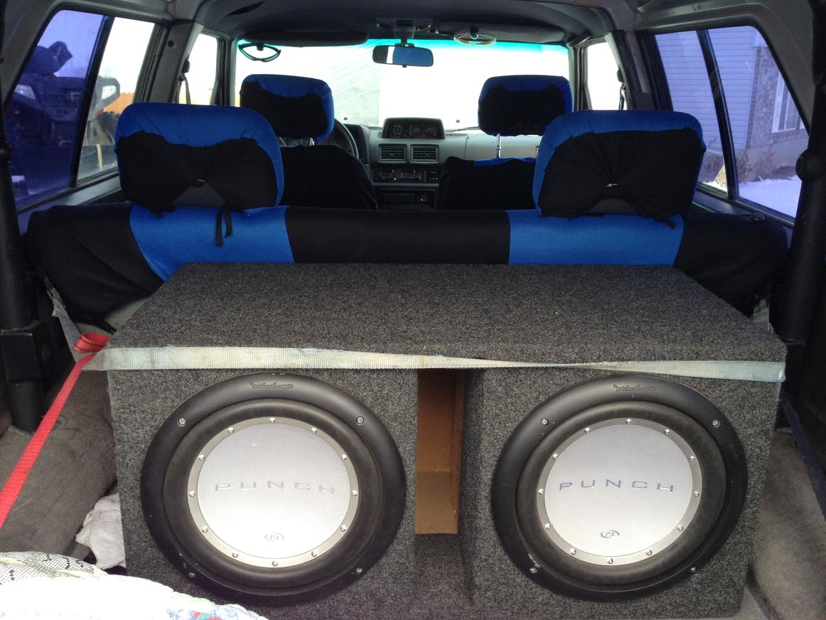

After the rims and tires I needed better sound on the interior so I wired up some subs and put in a Kenwood deck. It was definitely the easiest vehicle I have ever wired. Nice and easy to make the cords disappear under the carpet. It took a little modifying to get the deck to fit tight but it works fine.
Specs:
Stock front speakers - looking to replace them with some Rockford's also
Rear speakers - Rockford Fosgate T1572 - 70 watt RMS 140 watt peak
Subwoofers - 12" Rockford Fosgate P3 - 4 ohm 400 watt RMS 800 watt peak
Deck - Kenwood KDC-HD552U - 22 watts x 4 RMS 50 watt peak
Amp - Kenwood KAC-9105D - 500 watt RMS x 1 @ 4 ohms 1800 watt peak

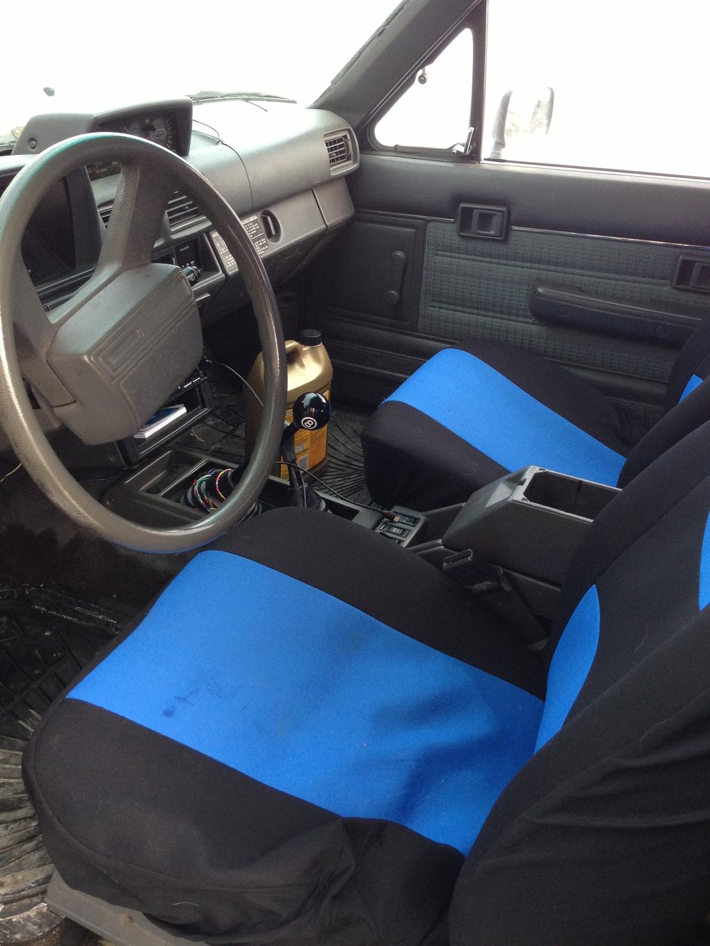

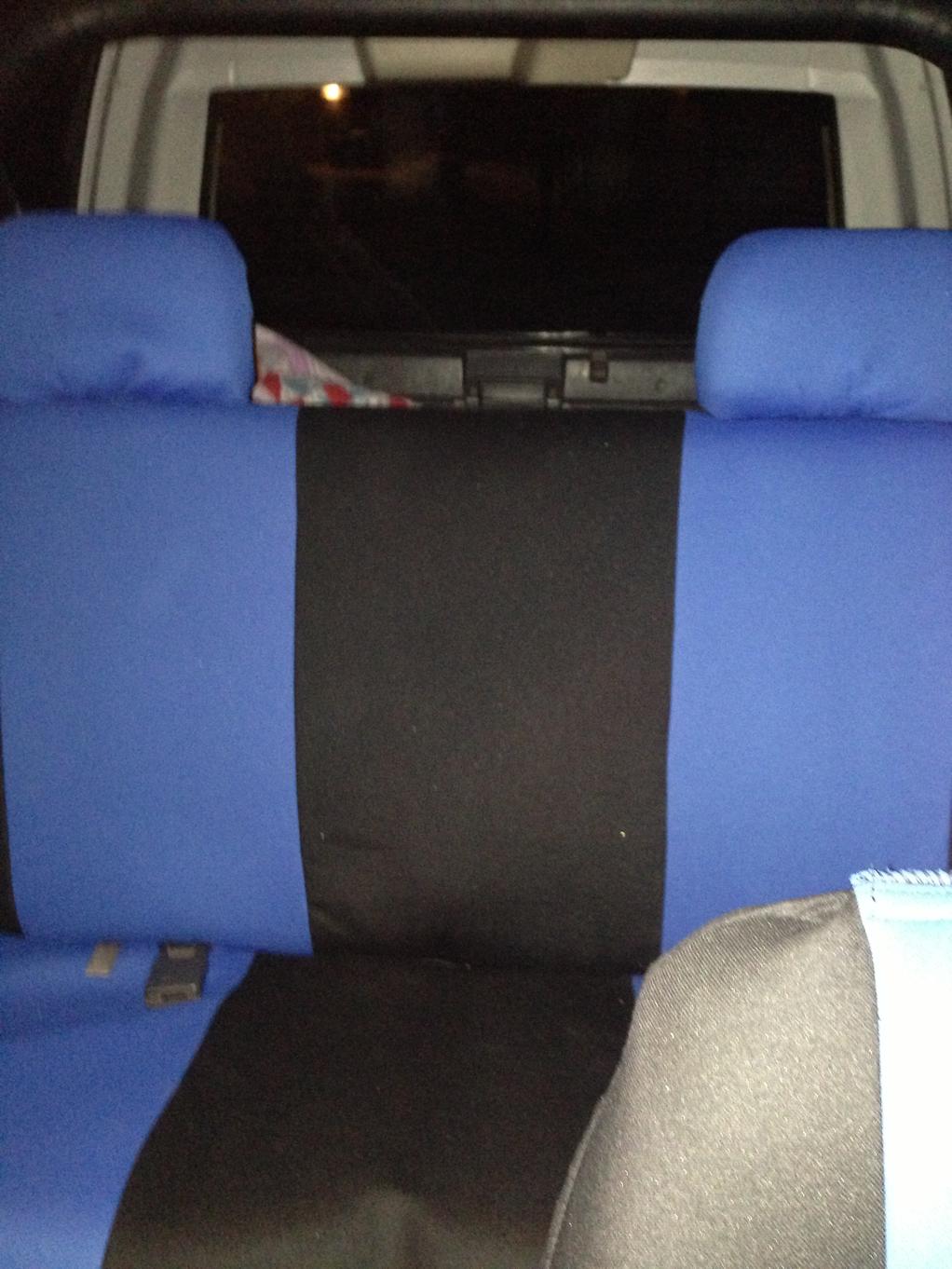

I aslo took out that nasty fabric covering the shifters then plasti-dipped the sheet of metal on the bottom cause it was gross and rusty. Ended up buying some seat covers and trimable floor mats too.
