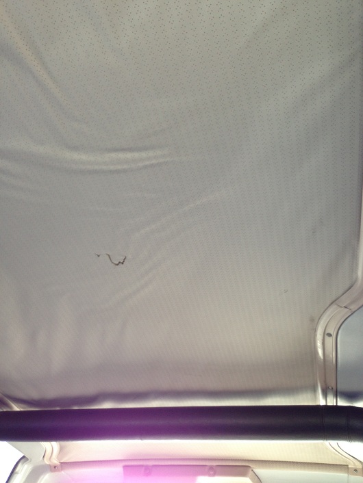

I forgot to mention I switched out my white shell for a black one. I think it looks a lot better. I didn't realize it at the time but it ended up having tint on it which is pretty nice. I picked up the black one for $20 and sold my white one to a friend for $15 cause he needed a window out of it after we rolled his 85. The material on the top had a lot more holes and tears in it than my white shell so I ended up ripping off the material on both and gluing the not so torn one onto my black shell. I did it pretty quick but it looks ok. I think I'm going to end up tearing all of the tint off of the shell then having all of my windows done professionally.

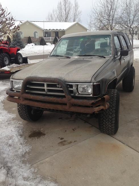

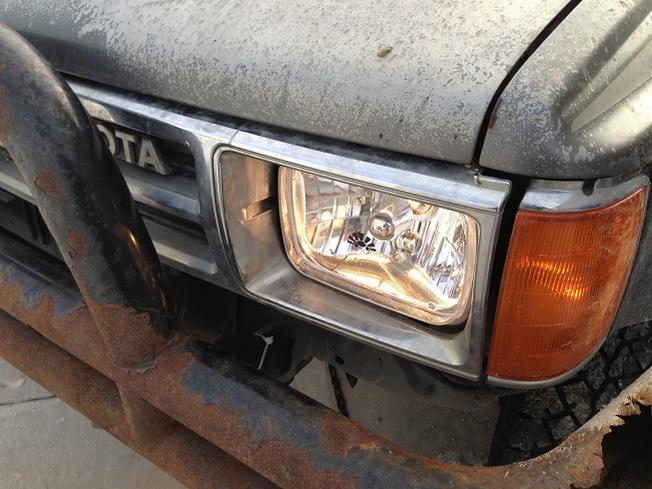

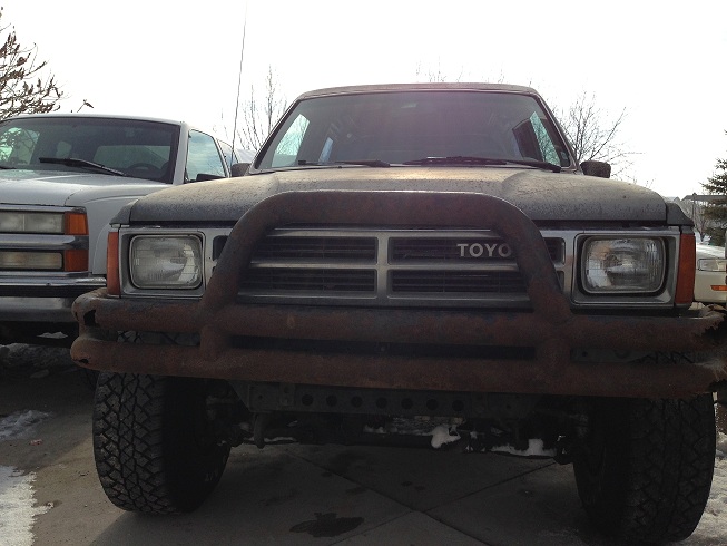

Round Eyes came today!! They look amazing compared to my other ones. I hope the plastic holds up though... Here is one before and a couple afters :D

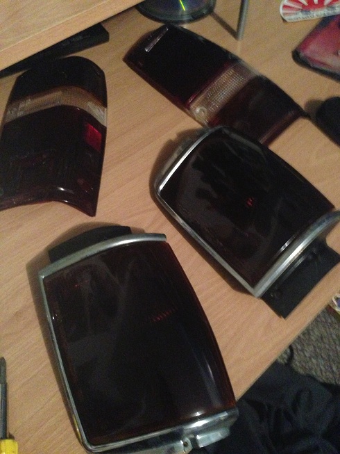

I got a can of Nite-Shades and tinted my tail lights and blinkers. It is hard to get an even coat with that stuff, but it turned out fine. Tested today by driving right next to a cop. He didn't even look twice :reddance:

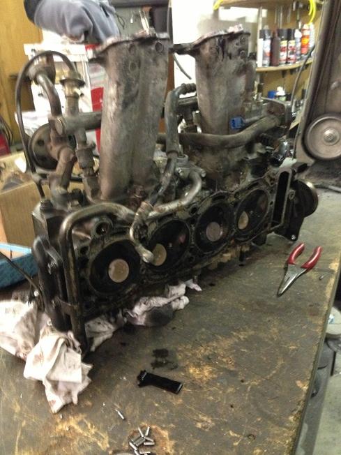

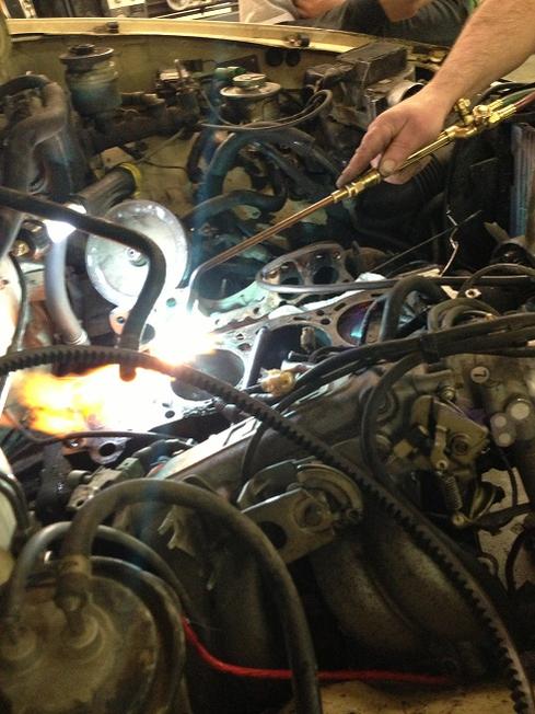

Had to tear into my friend's engine this week to replace his head gasket. We got it all torn apart but he broke one of the head bolts off in the block so we tried everything but can't get it out. Might end up taking out the entire engine... It's nice working on all this stuff though because I'm learning a lot. I'm going to have to do the same thing to replace my timing chain in the future.
I had a bolt snap off in my 66' Chevy. It was in a 250ci str8 6. I busted a exhaust manifold bolt in the head. It broke of below flush. I ended up snaping an easy out in the bolt. I towed the truck to my local machine shop. They were able to drill out the busted easy out, then filled the rest of the bolt hole with a welder. Then they welded a small piece of steel on the end of the weld. With a little heat they turned it right out with a pair of vise grips.
Bolts can be such a pain.
