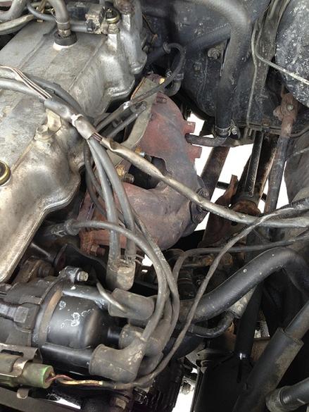

So when it came to the engine I figured I would start with the exhaust leak. I just took off the manifold and replaced the gasket and that helped a lot. I didn't get new seals for the bottom part of the manifold though so there is a small leak there, but not near as bad as it was. After the exhaust got quieted down it sounded like a valve was loose. I wasn't too worried about it because it sounded like a pretty time consuming job to adjust them.
The alternator belt was loose and very noisy so I tightened that up. No more grinding and slipping made the engine much more appealing to listen to.
I put a can of seafoam in a full tank of gas. At the time I wasn't aware it's better to do it in the vacuum line and whatever. With that in the tank it ran terribly with low power and got horrible gas mileage and didn't improve on the next couple tanks. I tried putting it in the vacuum line but didn't get much improvement. The valve was getting noisier so I decided I might as well do that. I pulled off the valve cover and the back valve was way loose. I also noticed the distributer cap and rotor were toast so I replaced them also. After adjustment the noise reduction was very noticeable, but not completely gone. I got low end power back and not so jumpy. Runs better than ever :D
