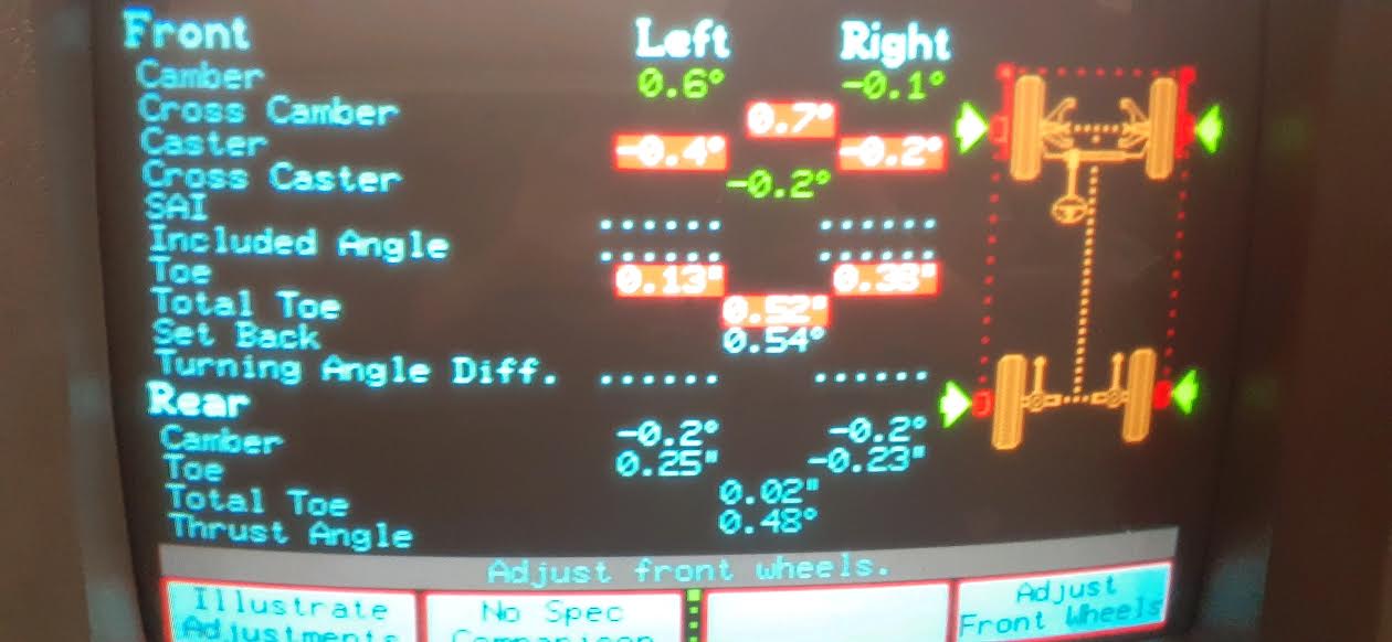

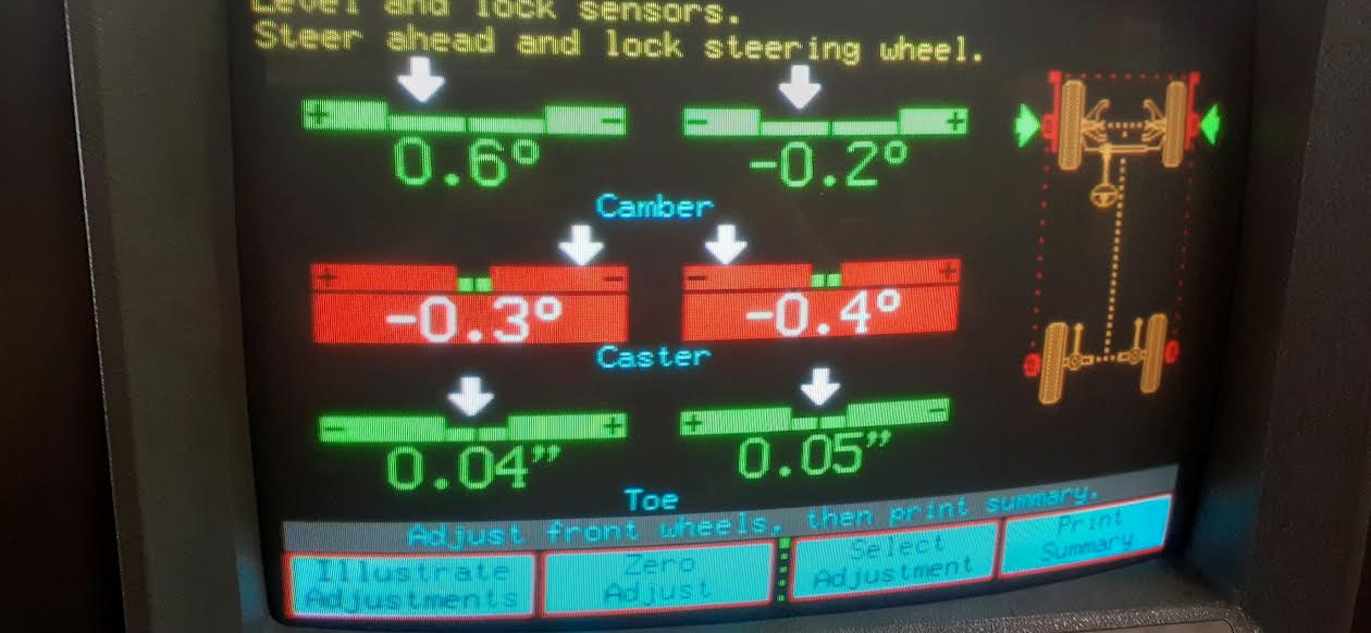

As requested, the alignment numbers, they're Greek to me, but I assume they'll make sense to more inclined minds.
Which one is before and after? Honestly they are both pretty bad given that is negative caster and you could do with A LOT more caster. You are genuinely in the range of it being at least a little dangerous to drive. I bet she really likes to follow every bump and undulation in the road doesn't she? It will be probably worth it to you too shell out the money for the job if you don't have time.

Before is the one with the blue words on the left.
