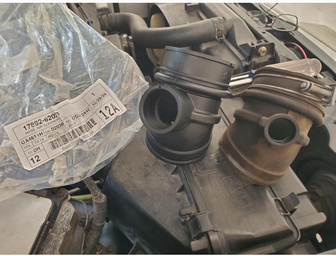

Here is the cause of an 0171 on mine, largest air intake 'hose' nearest intake had a crack that could only be seen if pulled apart just a hair yet the leak was there regardless, went OEM and smilin' since!

I just did this over the weekend, along with the A/C idler pulley. What a world of difference it made in the power and sound. I was about to start troubleshooting a phantom miss at idle, but the Boot was the cause of all my issues!

I bought the part in your post and went to install it today and found the hole in the side to be much larger in the new one. Should I have ordered something different? Or do I need a different plug?

They have different air cleaner hoses for build date.
17882-62010 5VZFE..VZN18* (07/1998 - 07/2000)
17882-62020 5VZFE..VZN18* (08/2000 - )
