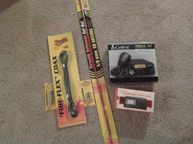

Driffter, I hope all is well. How is the new cutting rig coming along? Would it help speed up production if we sent you the money via PayPal up front? I'm willing to. I just received my Uniden CB radio, 18' coax, 4' Firestick and mounts so I'll be starting in on the installation this weekend. Can't wait to get the antena mounted up.
Got everything from the radio to the SWR tester! All that is left is the mount!:D
