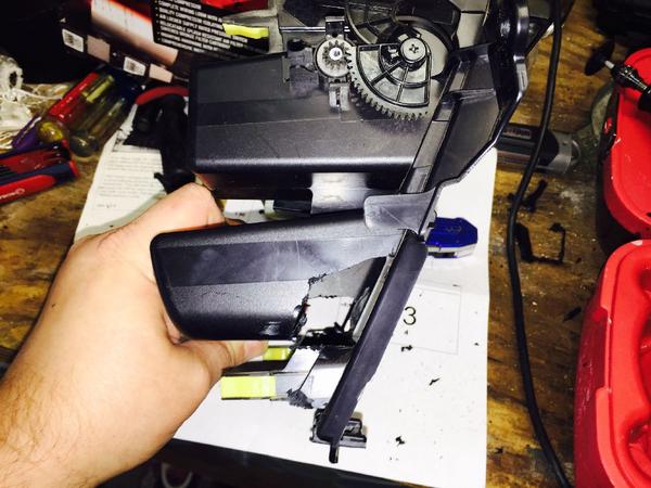

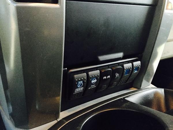

I will say, that spot is not very deep, but there is some ventilation on the back sides. I'm thinking that depth alone squashes that idea.
This may give you an idea of depth from when I installed my sPod.
