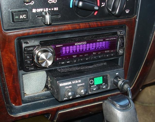

My stereo screen opens and covers it up when I'm not using it
I was just about to mention one I found, and then realized bNugs post has a pic of one just like it (post just above this). It has a front speaker and is DIN size, so you can mount it right in the dash below your stereo head unit. I haven't picked it up yet, but that's probably what I'm getting--I like not adding stuff below the dash, or tacking it on somewhere else, when the dash has a perfect spot for it (with the double-DIN factory pocket, that is--do they all have that?).

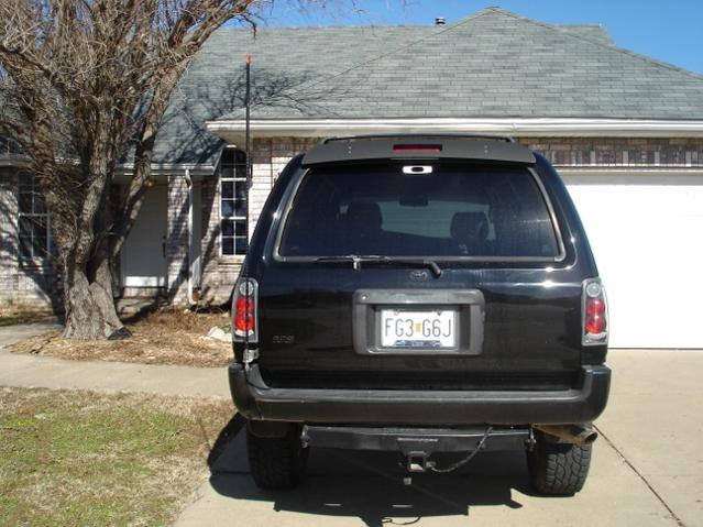

I went with a Hood channel mount and a med. spring with a 2ft antenna, works well enough for me
I got everything for free except the mount which I got from amazon.com. And yes it all works great.

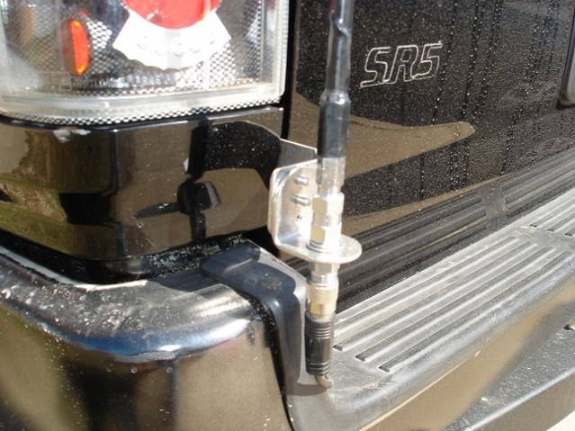

Thanks 04rnr! Where does the cable run? Is that 4Runner-specific or a universal bracket?
I the coax runs through the firewall, theres a hole with a rubber grommet that I fished it through.
I cant remember if the mount is for the 4runner, I think it is, but cant be sure, sorry.
in this pic you can see the mount

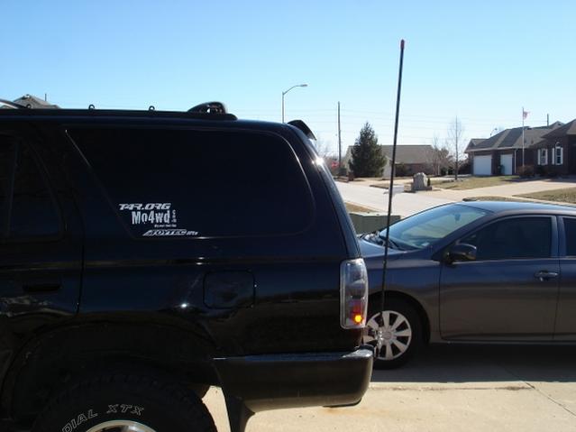

heres another
DSC_0007.jpg~original
This is a good option./\
On the roof its self would probably be the best for performance but if you go into garages, trees or anything that hangs low your antenna will take a beating.
Putting it on the fender farther away from the body should work better (performance wise) than a bumper mounted antenna. With a bumper mounted antenna you have allot of metal close to the antenna and that could affect performance.
Get a top loaded antenna and make sure it sticks at least a foot or more above the vehicle for better performance. If it doesn’t go that far above the body it doesn’t mean it won’t work. It just means it may not transmit and receive as good, but will probably be more than adequate for closer communications like on the trial.
The higher then antenna the better it will probably perform, but the more likely it is to take a beating. There are tradeoffs. You may want to suffer on the performance side in order to keep from destroying antennas.
It is better to mount the antenna right to the body as opposed to a trunk, hatch back, door or anything else that attaches to the body. It is very important to get a good ground. Your mount can be a good ground but you should sand the paint off and attach to clean metal. Door, hoods, hatches etc. attached to the body with hinges. These hinges will be painted, so will the body where they attach. That is two layers of paint to get in the way of a good ground.
How you mount your antenna will have the greatest effect on how well you CB works. You can have the best CB in the world and a poorly mounted antenna and it won’t work as good as a cheap CB with a properly mounted antenna.
