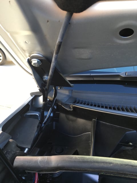

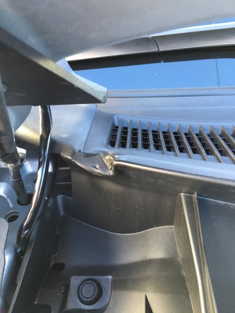

I have one that I'm using for my CB antenna, the bracket pushes the hood up. Some have cut out the piece of cowl that interferes. You don't need to, I used a heat gun to heat the plastic and then slammed the hood. Two times and it fit perfect, even if I took it back off no one would ever notice the small melted spot.
I didn't get the best ground and had to run an additional grounding strap under the hood, others haven't.
I had the same problem as JHalko and basically did the same heat gun mod. I did tape a piece of wood the same width as the bracket and about 3/8" thick before heating the cowling to get a bit more clearance when the hood was closed.

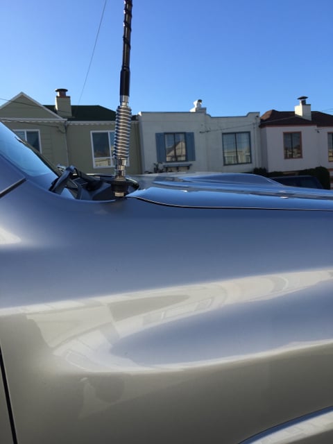

Here are a couple shots of the mount and what it looks like with the heat gun method. Super quick and only took 2 or 3 times of heating then slamming the hood.
I'm not really a fan of how the antenna looks there and I may end up putting it on the hatch or Gobi with a swing down mount later on. Gonna see if it grows on me but I doubt it.
Did you try a shorter antenna for daily driving? I ordered a 2ft white for daily stuff and a 5ft black for off road use and adventuring. I should have mine installed in a few weeks. I will post up pictures also. Thanks for showing the picture of where you melted the plastic.
