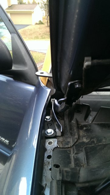

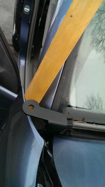

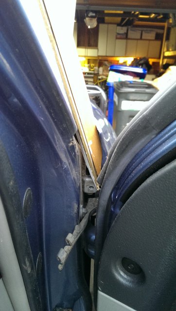

I just installed these by myself. A few things I did that made it a bit easier (some have already been mentioned in this thread).
-Unbolt the (3) bolts that hold the fender - 2 in engine bay & 1 in door jam. You can get away with (2) but I found I could pull the fender out more with 3.
-I wedged a piece of wood between the front fender and body. You may want to put some tape around the area to avoid scratches. Much easier to access the (2) hood bolts with the fender pulled out.
-Support the hood. Once you remove the 2 bolts holding the bracket the hood is free to move on that side.

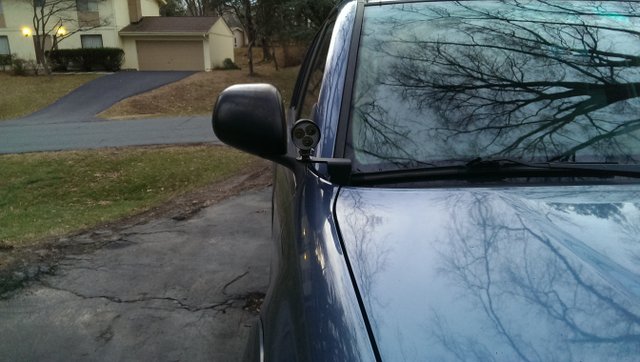

I ordered one of the ditch light brackets and it came today, decided I'd install it after work.
But unlike most of you all, I will be using it as my CB Antenna Mount, I don't really want anymore lights at the moment, but who knows, I may change my mind down the line and add lights to it (and reroute my CB antenna wire for a 3rd time).
install was pretty straightforward, although I probably made it more difficult for myself than it should've been and it took me about an hour (note to self: get high AFTER working on your car, not before...)
IMAG0755_zps2aa28042.jpg~original
I also cut half of the windshield trim so I could attach it back on, it looked kinda weird leaving it completely off
IMAG0758_zps19ecaeae.jpg~original
The stud for the cb antenna was actually not long enough because of how much thicker the cbi mount is compared to my old one so I'll have to go out to a hardware store tomorrow to get an extended stud.
